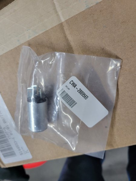

I have a pic somewhere but doesn’t it go into time delay canister

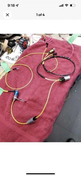

sorry to hijack. I’m doing the same wiring on a ‘70 with the A01 light package. Can you please describe what each wire is or where it goes?
1. Blue light on single yellow - is that the key or ash tray light?
2. Long yellow wire all alone = ?
3. Yellow wire with “L” connector = ?
4. Yellow wire with straight connector = ?
5. Clear bulb = ?
6. Pink wire - where does it connect?
THANK YOU!!

Examples of differences I’ve seen personally are map light has a plug in the glove box above liner, door jam switches incorporated in this circuit, pink wire goes to back of fuse box on pink circuit I believe is there time delay you’ll have to look 70 key light incorporated on steering column hence the time delay canister ( silver canister in pic of 68-69 )
yes i couldn't find anything in the service manual. But did find some info. its part of an A01 option with map light an interior lights with a time delay for the lights to go off like 5 seconds after the door is shut. I found in the old harness, the harness and connectors

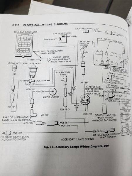

It's power, pink off of the delay timer, roughly 30 secs, is siamesed with another pink, going to the back of the fuse box. Third one from the right side, dome lite/ emergency. They already have piggy backs on the connectors.
I know that it says Dart, but should be the same. This FSM portral is why I like it better than the vinyl diagrams.

Thanks for the help. I like the CIGAR lighter in the diagram. C back in 69 even Mother Mopar new cigarettes where bad for us.
