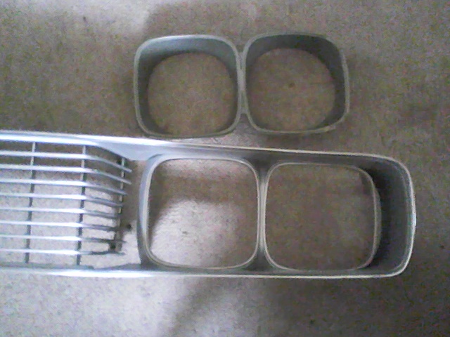

HOW DO YOU PUT THEM TOGETHER??? GLUE WHAT/ Not to mention crap fit.... any pics available... Picture 33.jpg
there is a plastic retainer that goes behind them and secures them to the grill that appears to be missing. they fit like **** after years of weather , heat / cold etc. they like to shrink. not much you can do except find a good set.

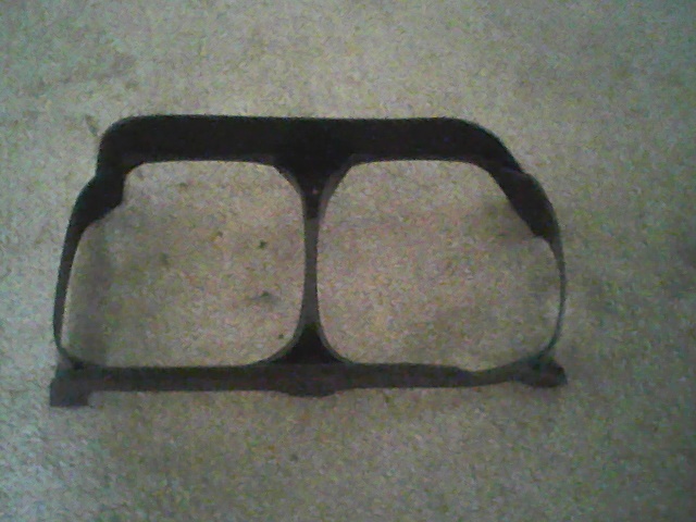

Picture 34.jpgwould you happen to have pic of retainer, I have a intire car in boxes new parts. every nut and bolt, amazing find. FOUND THEM???? BRAND NEW RAPPED IN PAPER.. THANKS 440SE.
yep that is it . they are left and right specific. its a tight squeeze when the parts are warped LOL I believe the headlight surrounds are left and right specific as well

Mike, you found the piece. It fits together and you will be able to tell if it is right or left. The headlamp bezel(s) only go in one way as well and they are the ones that usually shrink. The grille(s) themselves will be marked left or right on the back side they usually say "R" or "L" on them. And if not, the even number is always right.
6 screws, 3 top, 3 bottom. There should be posts on the grille with the little metal caps on them.
