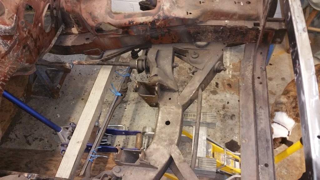

I take it you've seen my pics ..there is no weight on my front end ..I have no way to compress the suspension so I can remove the bump stops from under the upper a arm ..the driver adjuster is all the way in so I know there's a lot of pressure there..the pass is half way in ,so it's not as bad pressure wise..

Once you get the swaybars out, you can disconnect the strut bar, shock, and the spindle. Then you can unbolt and push out the lower control arm. Then, with the LCA on the bench, you can cut right through the adjuster with a large grinder. Of course, you have no way to move the car, so you better have a plan for that. A good car rotisserie is worth it weight in gold.

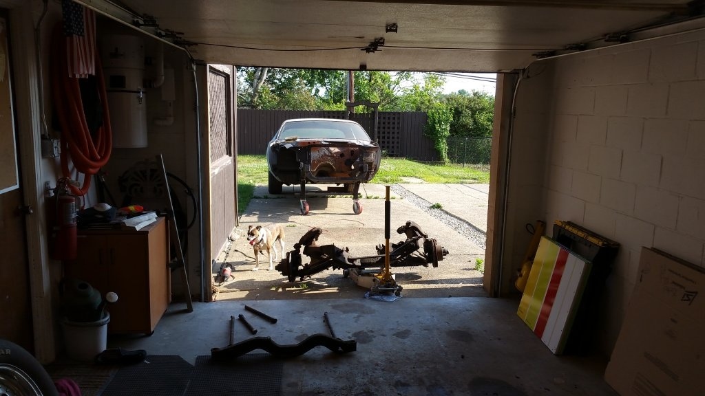

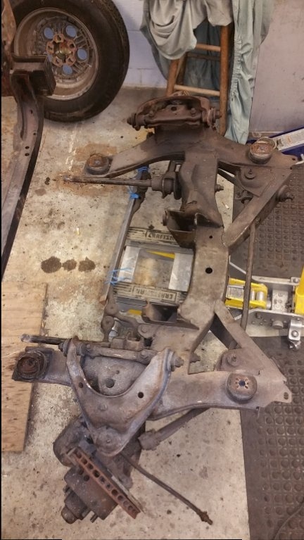

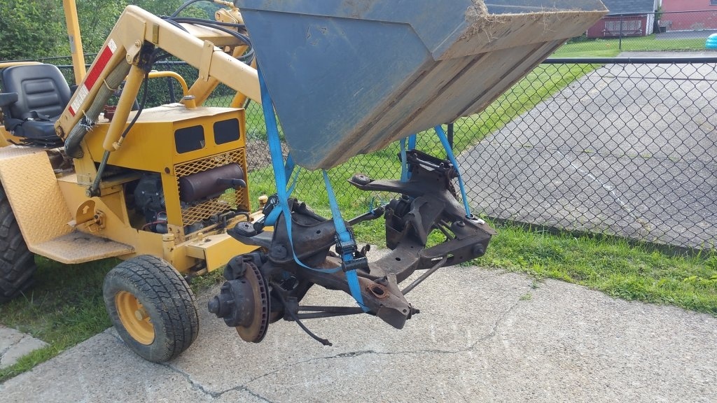

Well my anxiety over torsion bars was all for not.. (good thing). After confirming with firm feel twice that I can get new bars ..I brought home the torch and 10 minutes later and a small cardboard fire , the bars where cut with no issues. ..
And the k frame is now out of my way

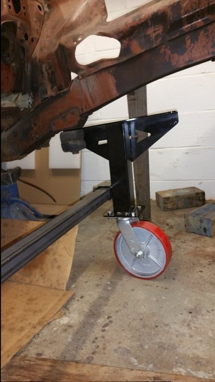

And...the mopar chassis dolly I bought from bestbuy automotive, auto twirler ..dose not fit the front end of a 73 charger..gonna have to make some adpters on Monday, good thing I'm in the shop on Monday and not out in the field. .

300 plus shipping.(my case was 120.00..they said truck ship but it came ups in three boxes ) .you can buy it powder coated. .but why ? It's going to get painted with the car , I just sprayed it with black spray paint .. I got the 8" casters but you can upgrade to 10" ..
Basically I went cheep ..lol...
Bestbuy automotive, was the least expensive set I was able to find...

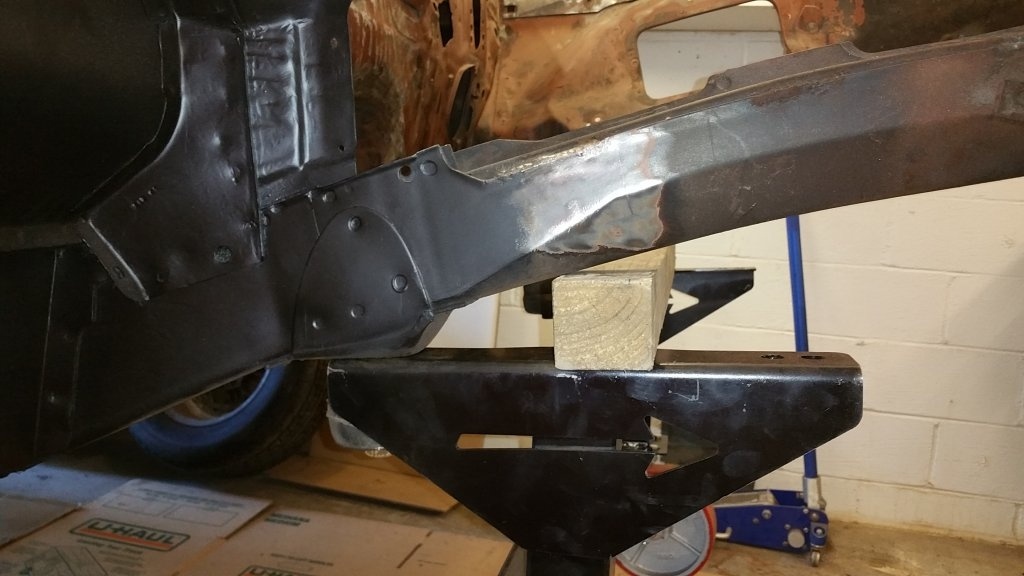

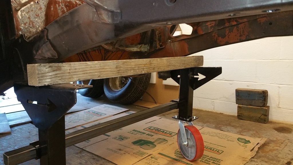

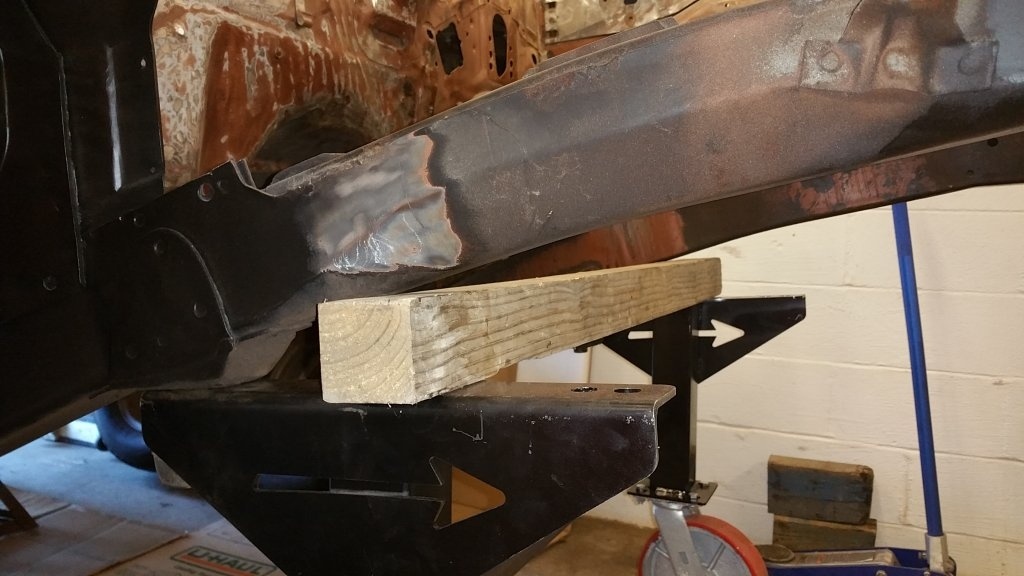

Now all 4 casters swivel. .Witch may be a problem for me, I will be moving the car by myself. ..so I may have to weld on a steering lock of some sort for the rear.
And only 2 casters have brakes ..

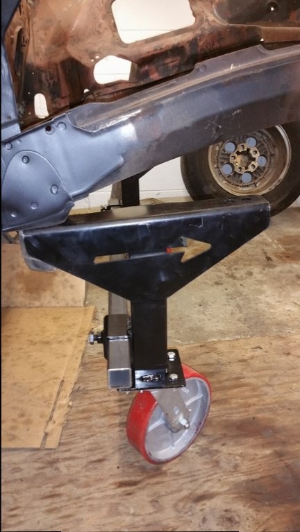

This is how I solved the mounting problem for the 73..
I tapped in a 4x4 to even out the pressure of moving. .but easily removed for working on that part of the rail
