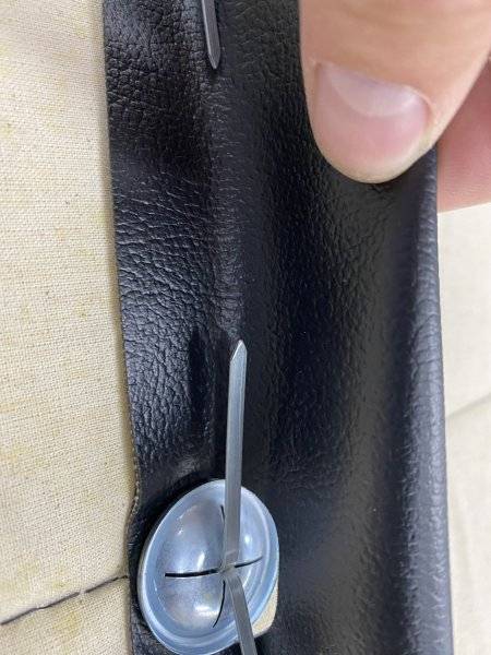

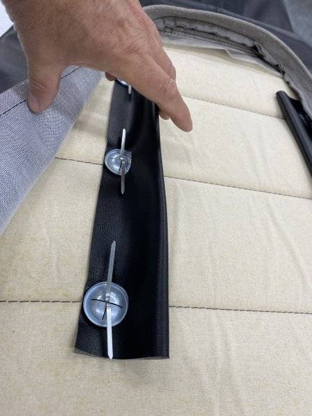

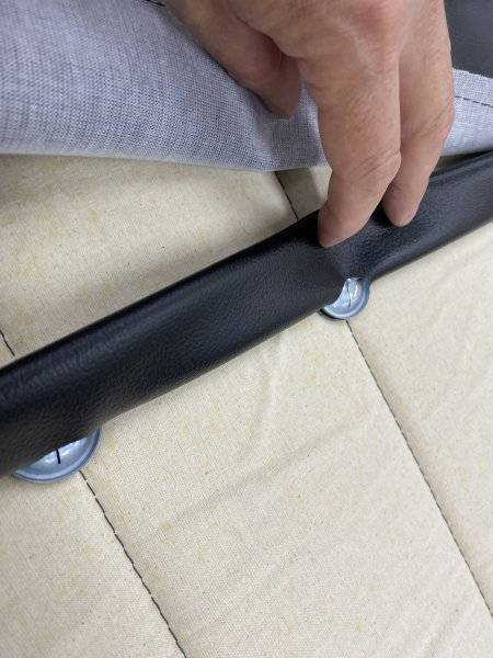

Held in place by the retainers. The retainers are 1-1/4" in diameter. The vinyl is 5" x 13" folded in half. The buttons come through about 1/2" in from the edge then a half moon is cut half way around the button so the vinyl can center itself when installed. Maybe a fender washer with a small diameter hole could be used as the retainer?? Definatly get the wires out of the old covers. More pics.

Thanks again for all your help. Those measurements are what I needed. Great pics! Already found some retainers that should work.
Yes you need those rods in there for the new covers. You can try and attach that material to the new covers, you will need some sort of retainer though as there is quite a bit of stretch down in towards the listing wire. Any cover I have purchased from Legendary already had them preinstalled.
