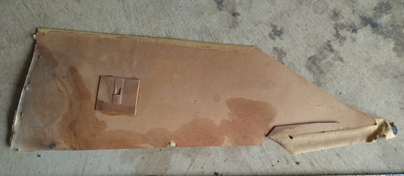

I'm in the process of making the interior of my '73 Charger.. uhh... livable. In looking through my pile-o-parts, I'm wondering how the sail panels attach. It looks like there is only one clip to hold it on. That can't possibly be true, can it? Has anyone installed these before. @Nacho-RT74
The one clip snugs it against the headliner and the rear, bottom, and front edges are held in by the window trim, rear panel, and SE louvers.
Makes sense. By "rear panel" do you mean the package tray?
Have no idea about SEs sail panel, sorry.
By observation I think is hold getting just overlaped by all the trim around
