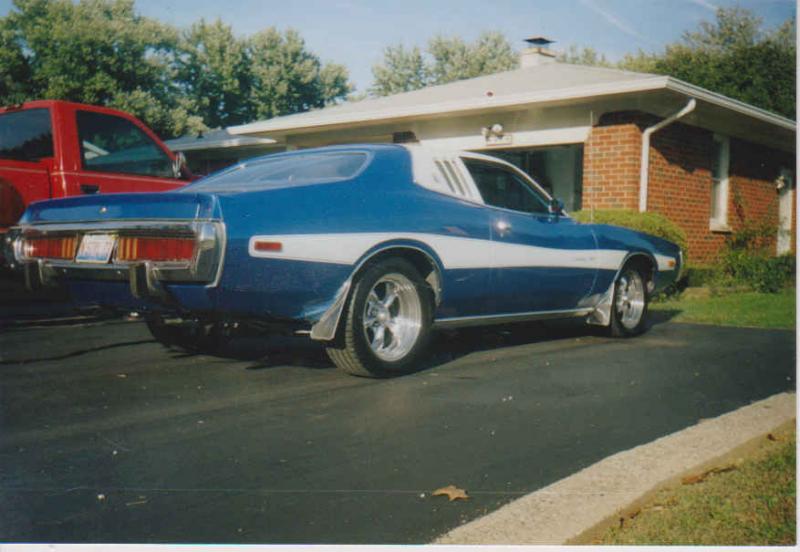

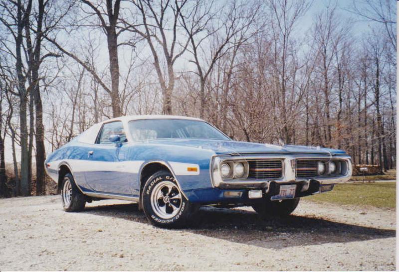

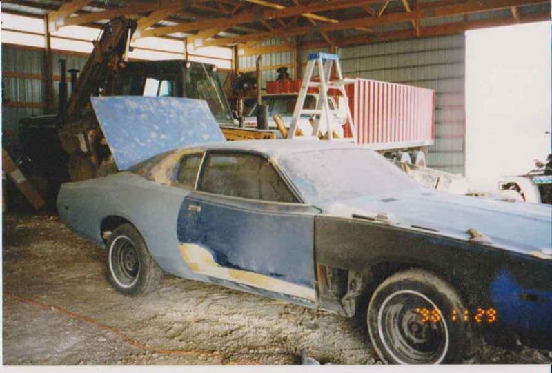

It is over 40, so it was bound to happen at some point. This is my first car and it is long overdue a little TLC. I bought the car at 15 and did all the work myself except the quarter panels and a $500 paint job for a total investment of a little less than $4k. 17 years later, after being basically stored poorly while I convinced myself I would work on it for the last 7 while it took a back burner to 4 kids, building a house and two moves, it is finally getting the upgrades I have been planning for a decade.
The finished pictures are from 1999 other than the one with the Torque Thrusts which was from 2006. I am the third owner of this 318/904/ 8 1/4" beast with 2.71 gears with all of the original paperwork. The interior is original except for the dash cap, but the last decade has taken its tole and everything except the door panels and seat covers will need replaced.
Like I said, I have been planning this for 10 years, so I have purchased 2 parts cars in order to acquire a lot of upgrade parts on a reasonable budget, about the same as my initial investment. I sure am glad that no one likes the 73-74 cars as much as the 71-72.

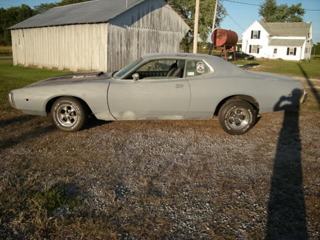

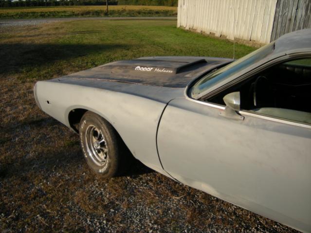

Luckily, as a 73 with a 318, it was never worth a lot, so I just kept it thinking I could always do whatever I eventually wanted to do to it without feeling bad. And now, I'm glad I kept it. My first post may have been a bit confusing. The picture of the car in the shed, in primer, was from when I bought it in '98. Currently the car looks like the 2006 picture, but the headliner and carpet have fallen victim to mice, and the dash cap cracked.
The plan is to steal the engine, transmission and rearend from my parts cars, as well as a few other pieces and redo the interior. The body is solid and the paint is pretty decent, probably a good 10 footer. It has sat for so long I would like to get it cleaned up and going without blowing the whole thing apart for a restoration.

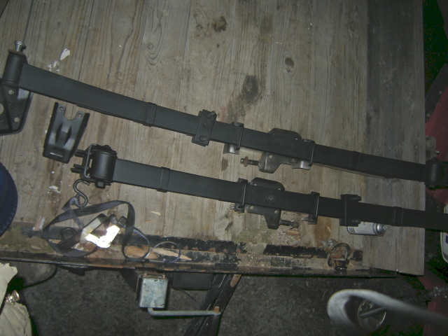

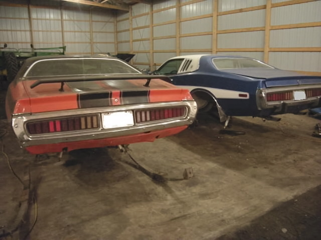

I don't have the best place to work right now as I haven't finished my shop yet, but the old house foundation in the shed is serving duty currently. Here is the other donor car. It is donating the 8 3/4 housing and leaf springs as well as shock mounts and sway bar mounts as it has been converted to the 71-72 style at some point. It was converted to the green bearings with Moser axles and has a set of traction bars that I will probably just leave bolted to the springs for now. Apparently when this was done, they put new bushings in the springs as well.
I will have to put new bushings in the upper shackle mounts of my car as they are shot. Are they two piece that press in from each side or are they one piece? The pictures I saw online of the replacement ones were two piece, but mine appear to be one piece.

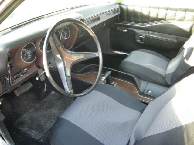

So, I realized maybe I should have put this in the restoration/project area, but I guess it doesn't hurt anything here. I stripped the carpet and jute out of the interior as well as the headliner. The headliner is only a four bow. Also, the carpet was one piece, but all of the replacement carpet I have found is two piece. Does someone make one piece carpet for these? Or are the pictures incorrect and it really comes as one piece?

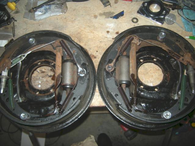

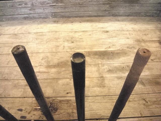

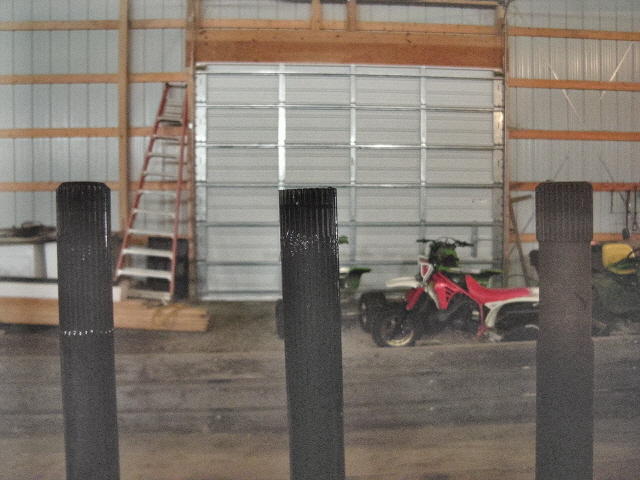

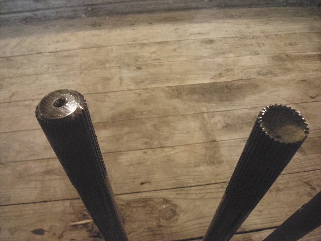

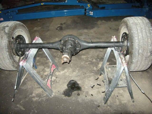

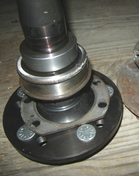

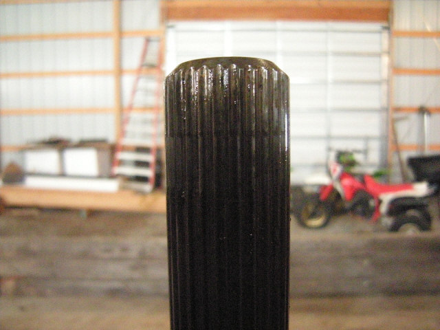

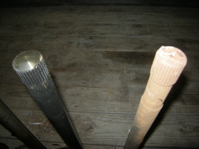

The negative degree weather has put a chill on my motivation. I pulled the rear out of all three cars to put the best parts together. I got a pretty fresh set of 11" brakes as well as new parking brake cables. Once I opened the rear ends up is when the problems started. I had driven all of the cars and one had a noise in the rear that I was afraid was the gears, so I was planning to use the 3.91 setup out of the other car. The 3.91's have a locker that was installed in an open differential so the thrust block was still intact and not easily removed and the axles had been cut with green bearings installed.
The other 8 3/4 is a cone type SG and from what I read, the thrust block is not easily removed from them either and I am guessing that the sound in the rear end was from the full length axles with green bearings that were home-made shimmed out and then tightened down against the thrust block. I measured all of the axles, the housings, the thrust blocks, found a stock housing and axles to measure and this setup comes out about 1/2" too wide for the housing. Their spacers took up about 3/8". It took some time reading and a couple phone calls, but for now I am just running the cut axles in the 3.91 gears and will explore my options for reassembling the other 8 3/4". The 8 1/4 is getting plugged back into the orange car.
Also, are these what you would need to run the stock tapered bearings? I do have a stock housing and stock axles. http://www.ebay.com/itm/251538902117?_trksid=p2060778.m1438.l2649&ssPageName=STRK%3AMEBIDX%3AIT

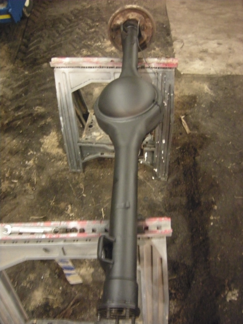

I finally got the rear end back under the car last week after fighting the shackle bushings and a wheel cylinder issue. One small problem with the deeper gears, they left two really long blacks strips when I first pulled out of the driveway. Is there a fix for that? :icon_winkle: After driving the 318 with 3.91's, I think a five speed swap with a small block and deep gears would be a pretty nice driver but I am well down this 440 path already. The car went to the body shop to have the hood painted and installed.

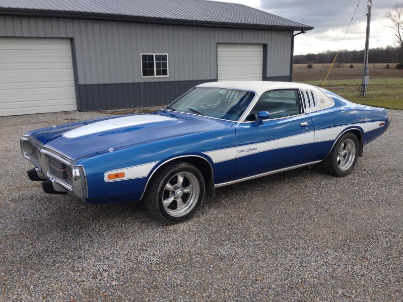

ITS BACK! It finally came back from the body shop after 9 months to put a hood on, but it turned out nicely and the price ended up being perfect. Now the work really begins.
Nstyle, that looks great. I considered doing that with my 73 as well with the Rallye stripes but with the white interior and red I thought it would be too much. So I stuck with just the simple SuperBee hood.
Can't wait to see more pics.
I wondered if the hood decal would be too much also, but with the blue interior and the flat hood, there were several acres of blue that needed breaking up when you looked out the windshield. As always, plans change, so this car is receiving a slightly different drivetrain than originally planned but should still be solid. Semi-Pro Touring is the target. I just can't bring myself to blow apart the whole car when its not rusty and doesn't need painted and I still want it to retain that feel it has always had. Its weird, but its like it has always had a certain personality even though its just a car, and I want to keep that. I have other cars that will someday fill the Pro-Touring niche.
As mentioned, I was going to go with the Rallye stripes on the side and the hood, this
with S/E instead of R/T.
But again I went with the factory white stripe and I am happy with my decision.
But I am very impressed with the look of yours, i really like that.

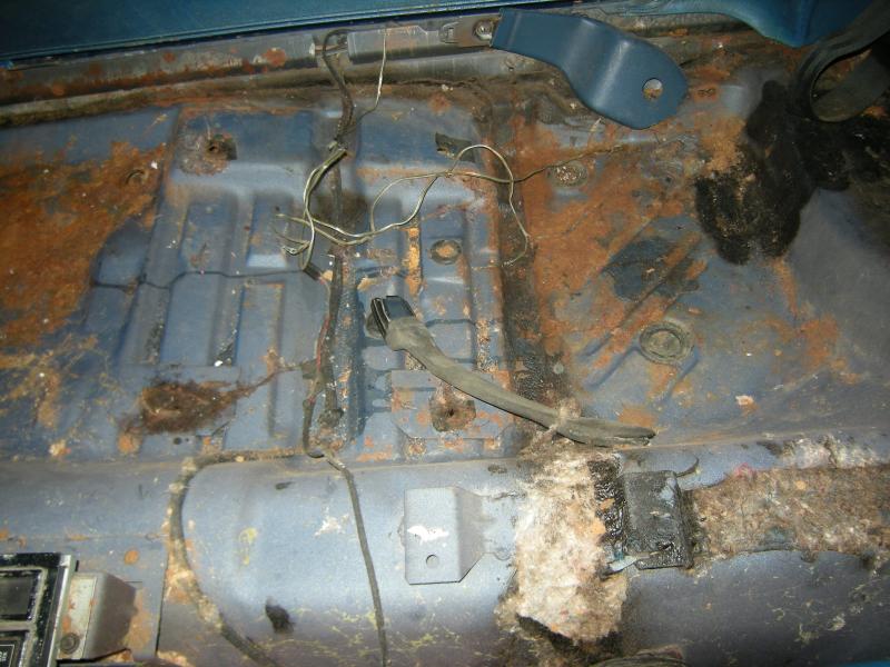

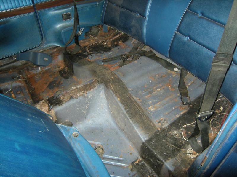

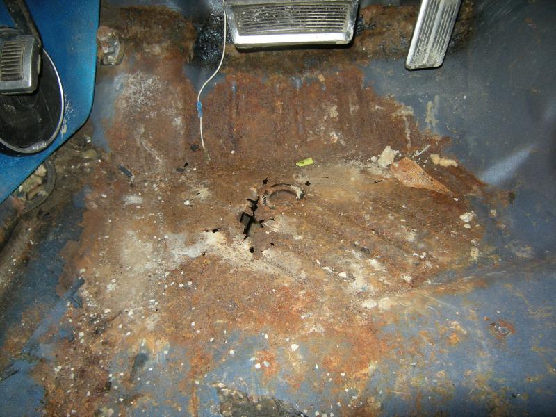

I pulled the carpet out to see how bad the driver's floor pan is rusted. Its not good, but could be worse. There will be some welding for the four speed hump anyway. The rest looks ok other than some surface rust.
