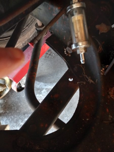

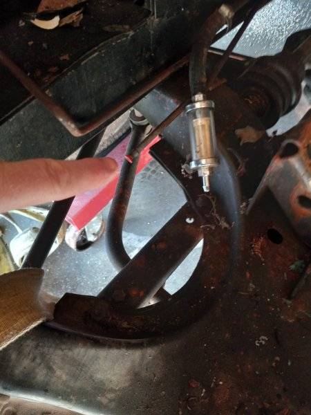

I need a bit of help on figuring out this fuel line that was blocked off when I received the car. I believe it is the return line for the original 4 barrel setup? The car has a six pack setup on it and I'm really not sure at this point if they ever had it running with the setup. I have the engine out of the car right now rebuilding it and I'm starting to clean up the engine bay and I noticed this. Should I worry about it? Let me know, thanks!! Kraig
That armored cut and capped line appears to be vent line to me. Regardless, IMO you should have a 1/4 return and a 3/8 fuel line with a six pack. Mopar started that in 68 to alleviate problems with vapor lock on the 440 and Hemi cars. I believe they followed thru in later years as well.
OK, thanks! I find it interesting they have the vent line coming all the way up into the engine bay?
California emission six pack cars, and others, have a vent line in the engine bay for the center carburetor fuel bowl vent
PurpleBeeper, from the tank? Now that I think about it, the car does have the charcoal canister yet. Labeled ports are DIST VAC, PVC, FUEL TANK (is this for that vacuum return line? and CAR BOWL.
When I got my Charger from its previous owner it had the same thing, a screw inside the hose with a clam around it. Drove it like that for many years. Now during my resto just figuring out what to do with it.

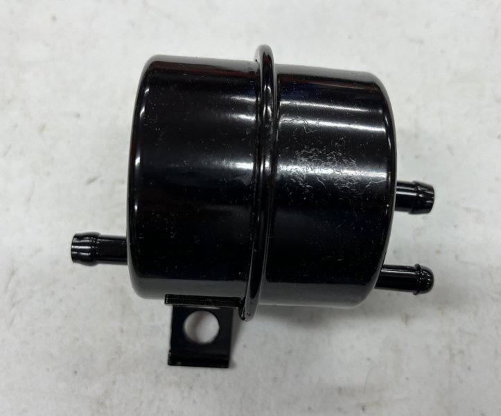

If it's a factory 440 car then it came with a 1/4" return line. The return is fed from the filter/Separator that looks like this.
T2R9, it is a factree 440 car. I’ll have another look for that fuel filter/separator. Is it located in the engine bay? That would make sense as that is where the line is.
If the separator was still there, it would have been mounted on the front fuel pump bolt.
