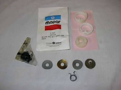

Hello everyone,
I thought being a Firefighter and Paramedic was tough, I think working on this Charger is worse. :( I removed my wiper assembly and installed nylon bushings. However, the wipers still do not work. It has a 2 speed motor. The transmission linkage has issues. I attached a video, hopefully you can view it. Can these be repaired or does it need to be replaced?
Thanks
Hello everyone,
Thanks
Did you replace all the cams inside the boot?
No, that's probably the problem. I was afraid to open it up, thinking that I wouldn't be able to put it back together. Thanks for the response.
Where can you buy that repair kit?

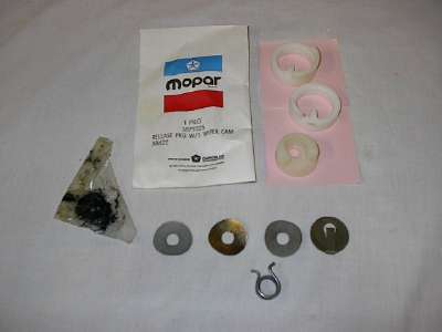

They pop up on ebay a lot. should be around $40-$60. The NOS kit will have the 3 cam pieces and the metal retainer and spring. The newer repos are just the plastic cams...which is cool, as long as they are durable enough.
Thank you
