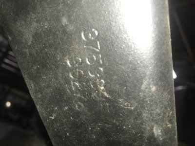

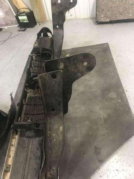

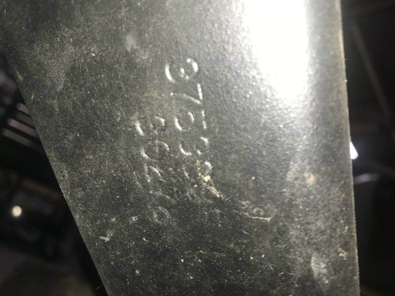

Could someone tell if these are 72 or 73 Brackets?
3D0CA985-F714-429B-9C2A-61615C6DE9CA.jpeg 49519312-4F0D-4154-9264-5E3D6B55064D.jpeg
Well they don't look my 72 brackets, close though! Mine all look like the bracket closest
I’m really hopeful they are 73 brackets but I have so much crap from so many cars. At this point I think this is the only set I have. So hopefully it works
the holes on the 72 brackets are about 7/8" higher or lower (dang can't remember) than the 73 because of the ISO K frame.
Actually it's the whole portion of the bracket, after the bend.
...and that's why they don't interchange.
Can you tell if that bumper had the big guard brackets on it, that would be a clue, although the bumpers do interchange on the brackets.
I didn’t think the 71-72 brackets had the round pcs that curves down at one end, not sure what’s that’s for maybe towing?
