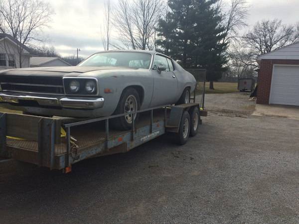

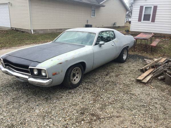

I started with a 1973 Plymouth Satellite. It is a factory A/C car with a factory 318. It ran and drove (albeit not well) I am pretty sure the main bearings on the engine were out and the valve guides as well… it smoked more than a 1970’s nascar fan… But it was a long time California car with perfect floors and what I thought was a great body!

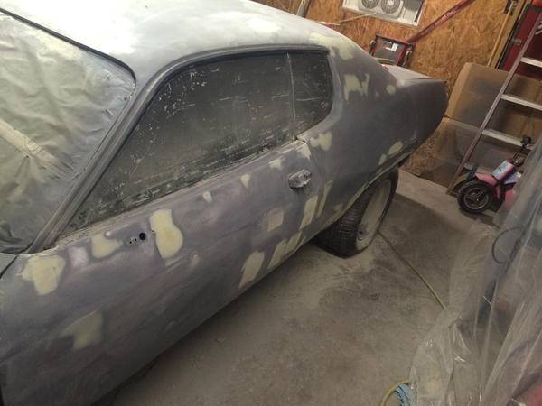

So off I went, first I decided to tackle the body because I knew my Gen 3 swap was gonna be costly and I wasn’t sure how exactly the best way to do it was…

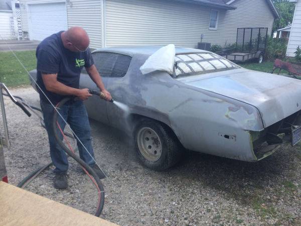

I had the body dustless blasted after I found some nasty looking filler in the rear quarters. For what it is worth, I like the simple, quick, nondestructive process of the dustless blasting but be warned. That crap get everywhere! You will find caked on glass sand in every nook and cranny ever created by those ma mopar engineers!
73 roadrunner project by rescuediver1982, on Flickr
I found out the rear quarters had been wrecked pretty good, but they don’t make swap quarters or patch panels for the sections I needed… So off to pull out some metal, massage steel, and bump them back into shape. With some filler, some primer, some more filler, and finally more primer. In the process I deleted the radio antenna and the fender mounted turn signals. (some people may not like that idea but I didn’t like the square turn signals on the nice rounded body...)

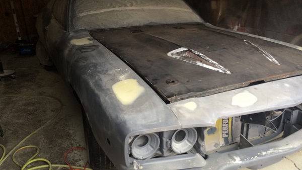

Ohh… and this cool OE RR hood from a swap forum on FB! It was in pretty good shape!

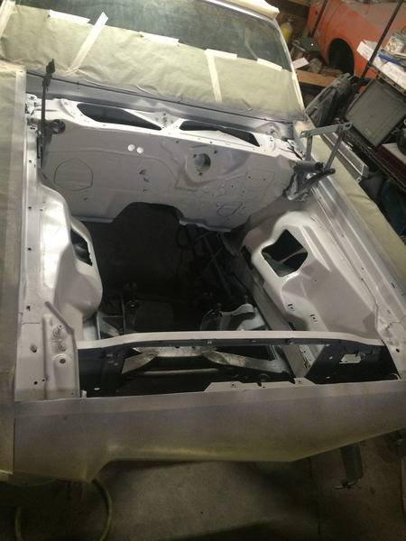

After much primer and body work, It was finally off to motor swap land!

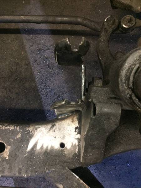

Now to mount it in place. I used a set of Schumacher spool mounts . They would have worked great if I didn’t want to use the low mount AC… but we can’t have that AC unit sitting way up in there now can we?!? So we cut the spools off and made our own mounts utilizing the basic design of the original spool mount!

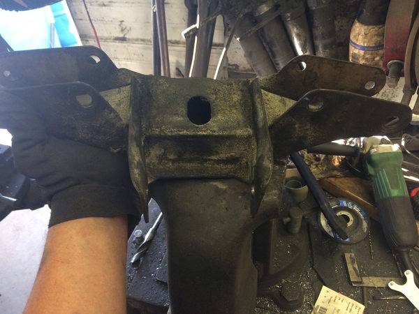

Here is the original mount:

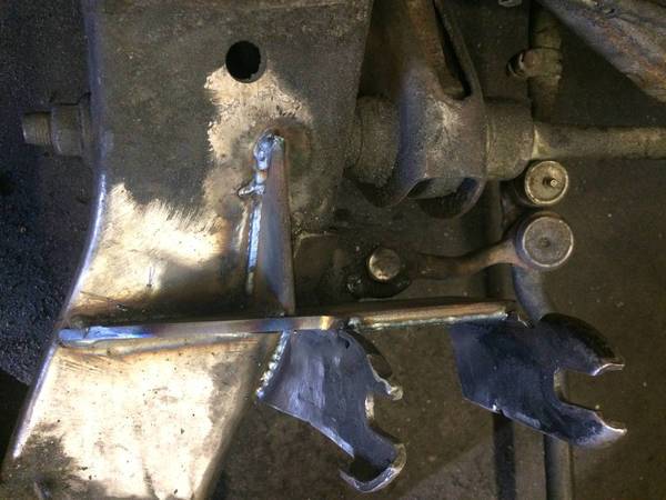

Essentially we cut the original horns off of the factor K-Member and flipped them around backwards! This sets them back about 3 inches and creates the space needed for the lower a/c compressor.
We used plate steel for gussets to reinforce the new k-member mounts:

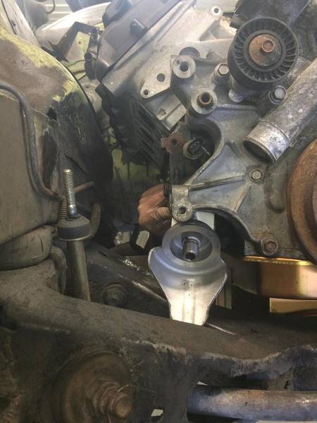

Then we set the engine back down on into place and lined up the spools with the plate we cut to mount to the block before welding them in place.
Untitled by rescuediver1982, on Flickr
A small spacer piece of box tubing was used as a spacer on one side.

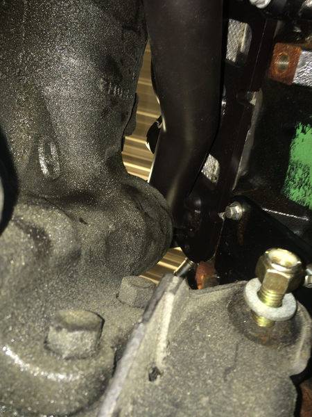

You must use a 45 degree oil filter adaptor. I got mine from Mancini without any issues.

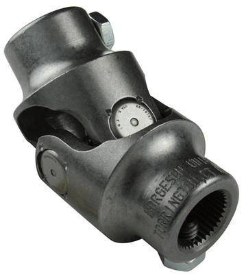

I used a Borgeson steering joint smooth shaft tubing to Chrysler spline and a union to go from the smooth shaft of the factory steer shaft to the new shaft I cut down. The Borgeson steering joint is much smaller and provided the clearance I needed to fit my headers completely unmolested! (yeah, no header dimples for me!)

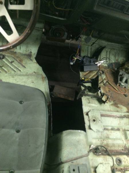

So now that the engine was mounted into place we had to get the transmission tunnel cut out and the 545RFE mounted into place. We started by cutting the tunnel out.

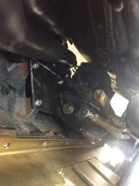

Now after we got the tunnel cut we had to make the transmission crossmember. It was pretty straight forward, I took the factory member, cut out the center and reinforced everything. We found a Chevy rubber transmission mount works nearly perfectly with this setup so I welded it all together pretty quickly!

There was no real magic to where we cut. We just tried to cut the least amount out as possible. I was able to cut a small enough amount out that we can make my factory AC/Heater box work!

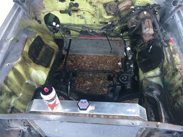

I used a low buck aluminum champion swap radiator. The Coronet 6.1 has a champion and had never had any issues as Nathan had been using them on his LS swaps for years and never had an issue! I used the swap radiator and found the LedFoot Racing shroud to match with 2- 12” fans all for 300 bucks shipped… Fit was ok, not the greatest. Be prepared to drill some bolt holes to get the flange to sealed to the cowl.

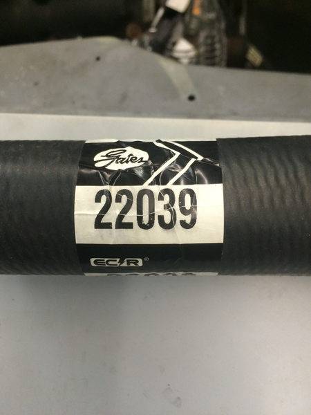

Lower coolant hose I used:
Upper Coolant hose I used:

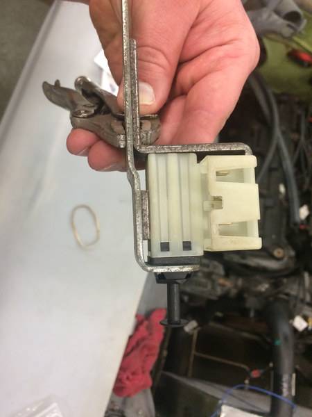

The Hotwire harness requires you use the proper brake switch from a 2005 ram I believe. We used the factory brake switch bracket from the car and modified it just a little bit. It now gets bolted right to the brake pedal like the factory switch!

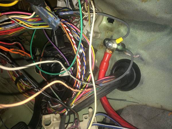

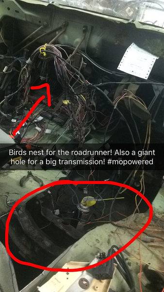

Wiring… ohh that wonderful, wonderful mess, Luckily I have Nathan! ?First if you haven’t figured it out, we used a hotwire harness. Super easy, everything was labeled. But to take make it all fit…. The old stuff though… that was the trick!

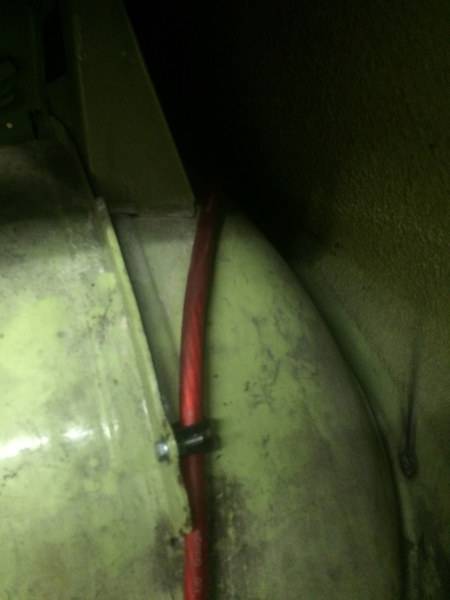

I relocated the battery to the trunk to really clean up the engine bay. To do so I ran 0 Gauge through the car using the factory wiring tunnels along the rockers. Once at the firewall we used an firewall passthrough stud block that worked out super slick.
From the trunk, across the rear tub, into the quarter, and through the passenger side wall into the cab

Into the wiring channel with a some notching, and an old piece of vacccum hose to cover the sharp edges.

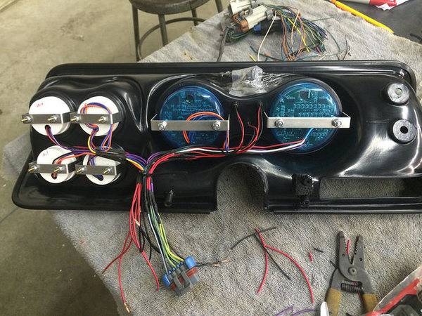

Then added some new Intellitronix LED gauges in a classic dash insert.

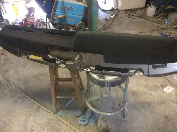

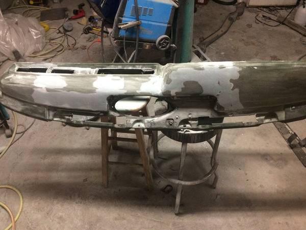

The dash got a little work too, the old one was cracked pretty bad. So some filler, some texturizer, and some paint and I created a little bit of an update.

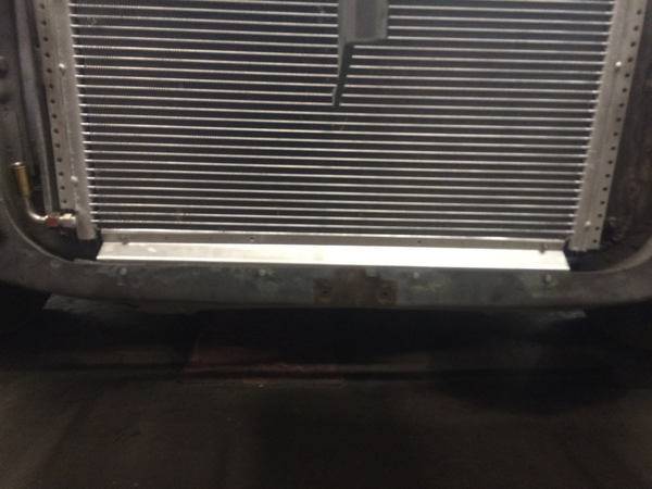

The A/C… this was a factory A/C car so I wanted to keep it an A/C car as this will be my daily driver… so I got a new evaporator for inside the factory a/c box, these gen 3 compressor fittings from Bouchillion, and set out to make our own system! We got a universal a/c condenser for the front, a dryer, and the required trinary switch!

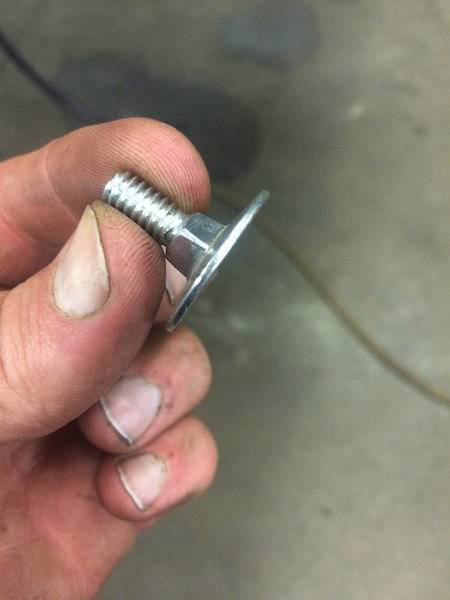

We utilized elevator bolts to secure the cold hoses inside the inner fender and hidden out of sight

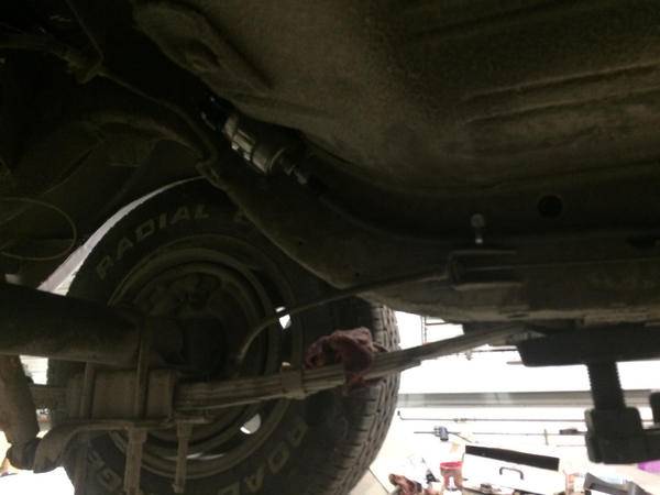

Fuel System- I used a Tank Inc in-tank unit with the slosh tray. Installation was pretty straight forward. The toughest part was removing all of the extra vent tubes from old factory fuel tank. We changed things up from the Tank’s Inc instructions by threading new bolts in from the bottom with extra sealer. The pump unit then just sits on top and you utilize nuts to keep it in place. This seemed much more secure than screwing it directly into the top of the tank’s sheet metal. I also utilized an aftermarket sending unit I got from Summit.

We ran the efi fuel line along the frame rail and used a corvette fuel filter to regulate the pressure down.

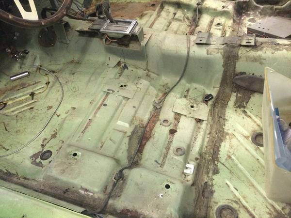

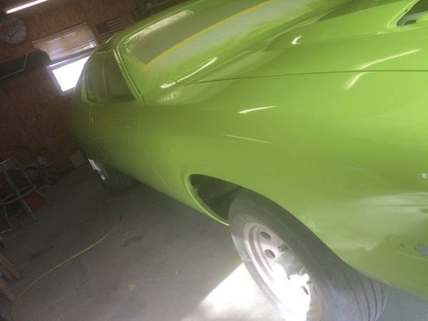

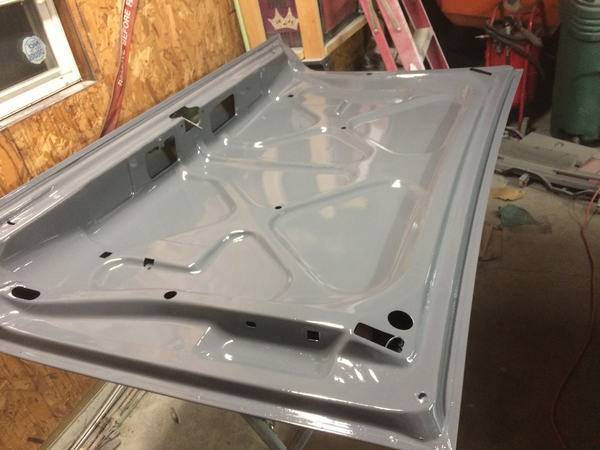

So after all of that, we tore it all out. Why you ask? Because it badly needed some paint… so between work, kids, an other obligations, I finally got the some paint on it! After I re-massaged some body work I had noticed while it was on the lift, I blocked it all down with 600 grit and reprimed it all. Followed up by 3 layers of PPG DBC2000 Sublime Pearl Green and covered it with 2 coats of All Kandy Wet Wet Plus clear coat… I am pretty happy especially since I have never painted anything of this magnitude!
