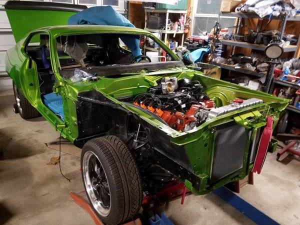

73 Roadrunner Clone with 5.7/545rfe (very pic heavy)
This is amazing, I thought about doing this when I started my restoration back in 2011, but now that I see what's involved, I am glad you did it and I kept my 340 RR pretty much original.!
I am glad I did it also but it has been very involved and is fairly costly. The motor, trans, and ECU were bad enough but its all of the little things that don't get mentioned. $500 headers, $100 gas pedal, $400 in factory sensors that you have to switch out to the old style or new style depending on your harness, all those little adapters and fittings, etc has added up slowly to some extra zeros and a comma in the price tag. I was trying to keep a running total of everything and trying to keep part numbers wrote down to really do a good write up on everything that was needed but in mess of trying to figure out if I needed a 09' charger sending unit or a 2005 ram sending unit for this or that, and is this piece metric thread or standard, I just lost the lists or they got overwritten with the next list of things to do or buy.

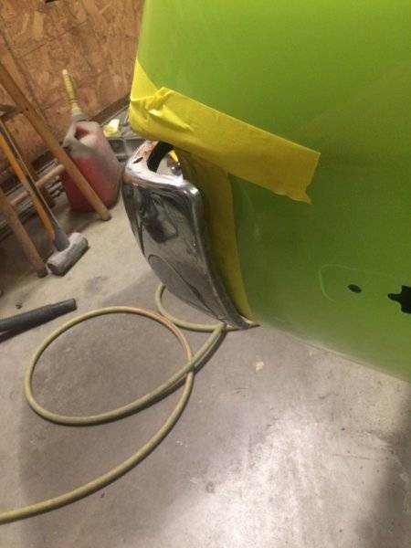

So I was able to get a little more done today...

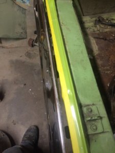

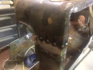

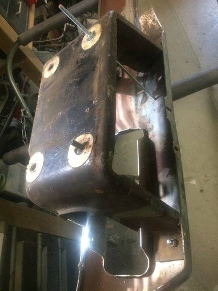

I mounted up the rear bumper and hated how far out it sat from the car. So with a little FBBO digging I found an awesome post with this link it to tuck the bumper up!
http://www.hotrod.com/articles/fix-disco-era-bumpers/
I didn’t take as much out as they did I only took an inch out of the mounts and it has made a huge difference!
Unfortunately I didnt take any before photos... but alas, I like the fitment. On to the next thing to button up!

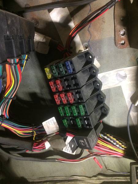

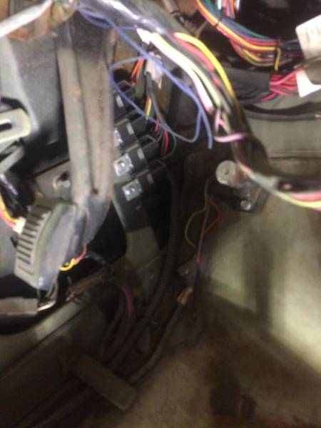

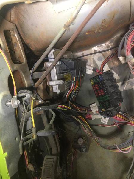

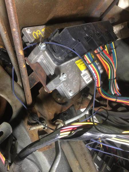

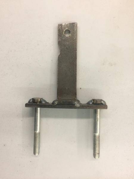

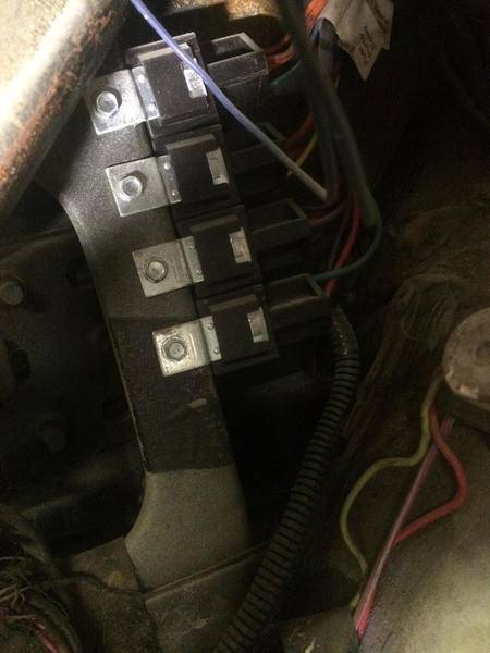

One thing I did not highlight well in my original post and usually is a contentious issue is how we mounted the Hemi ECU. It is mounted under the dash on the driver's side against the driver's side wall. Nathan made these trick standoff brackets to clear parking brake cable and hood release. So I snapped a few pictures of installed as well as the modified fuse blocks we used. The fuse blocks included in with Hotwire harness are a common and inexpensive slide together blocks that allow you to add as many rows as you want. I also grabbed a picture of how the relays are mounted inside the driver's side wall.

The mounting bracket for the ECU
Untitled by rescuediver1982, on Flickr
