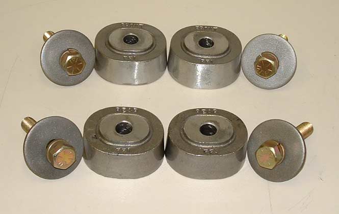

The 73 and 74 B bodies had rubber isolated front subframes. What you need to do is replace the rubber mounts with solid ones from someplace like Firm Feel. I actually found a set of factory cast iron ones from a police car and installed them on my 74 Road Runner. Made a world of difference. I also got rid of the rear Iso-clamp rubber leaf spring to axle mounts. Not good for performance and handling.
I have looked on Firm Feel for these rubber mount solid replacements and have yet to find them
http://www.firmfeel.com/b_body_late_mopar_sub_frame_isolators.html
I bought a set of polly pucks from Rock auto, they were only about $100 for all 6 needed pucks. 4 for the k frame and the 2 needed for the trans cross mount. I will be installing them later today to see if that helps any. First day of the race season is this Saturday. I have found another fabricator that is willing to look at the car to make a set of tq boxes and or frame connectors.
