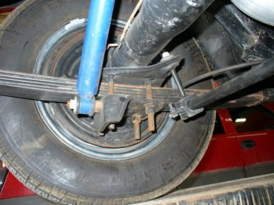

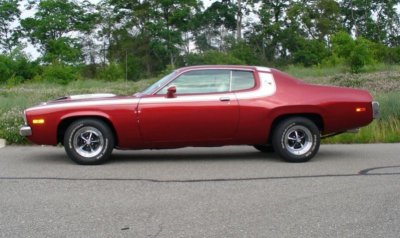

I had a local frame repair shop make me a new set of springs. They were a little stiffer than stock and curved to accomadate solid mounting to the axle (no more rubber isolators)
and to raise the back about an inch. I like the stance better now.
If you can't find a source over there I think FirmFeel here in the states might also have springs and the plates to replace the isolators.
