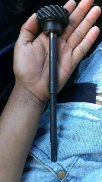

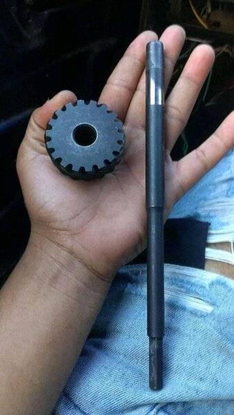

I only have seen this happening once on a friends car in around 20 years I'm playing with Mopars, which are the pics I posted

View attachment 946456 View attachment 946457
