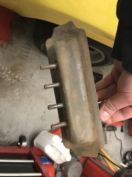

Here is the factory vapor separator for 73 RR.

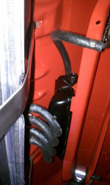

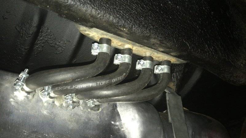

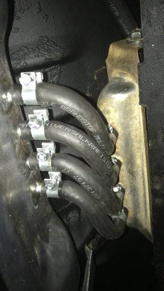

FYI, if you are using a stock tank, the 4 lines for vapor run across the top of the tank to each corner of the tank.

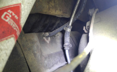

Well i definitely found the problem. Just needed yall to get me under the car and look for myself. I also just noticed how ridiculous my fuel line is. I never knew it had a rubber piece in the middle of the line like that.

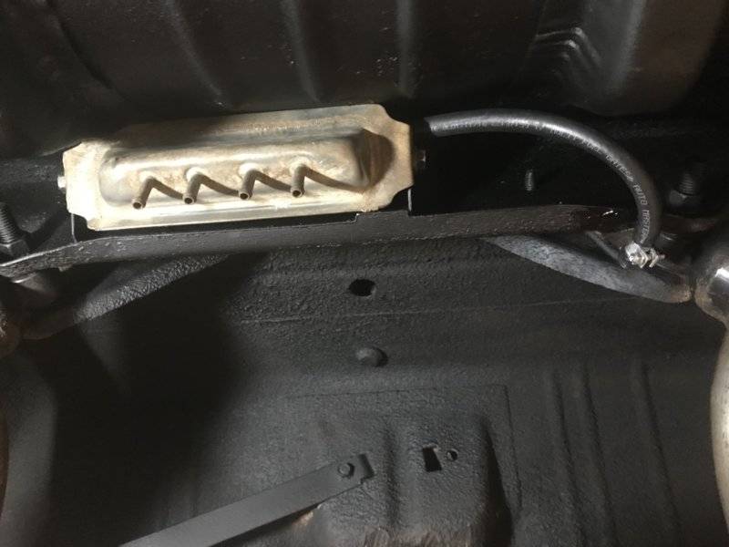

Yeah, get the correct tank, that's a good start, I am using a spectra premium. I don't know where you will be able to get a new vapor separator, I de-rusted my original and then painted it, but not 100% sure the internal valve still works 100% but I haven't had any issues with it.
I have a Spectra (made in Canada) as well.
Note the sender clamp rings are thin and crappy. Find an OEM one if you can.
Separator manifold is almost impossible to find.
