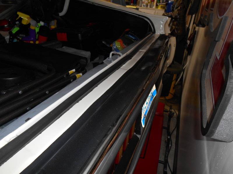

You can tuck them in by using brackets from the 71's or 72's with a little modification. The bumper fillers are very hard to come by now and no one is really re-popping them. The bumperettes(or bumper guards) can be tossed if that's what you are looking at. I kept mine on the 73 just because its a stock look for those cars. The wife made the bumper fillers while I was at work. She found a 16 foot roll of black garage-door rubber seal at Mennards. The width was perfect. Get a lot of compliments on the look.

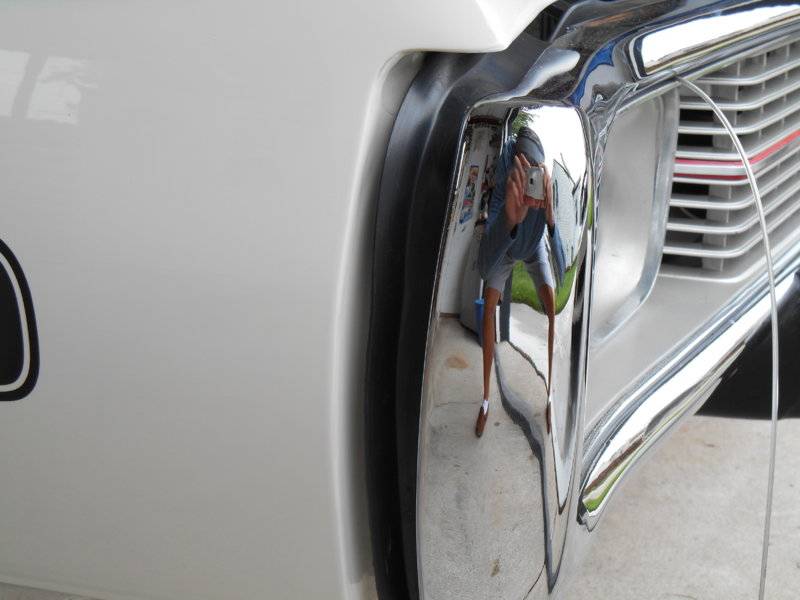

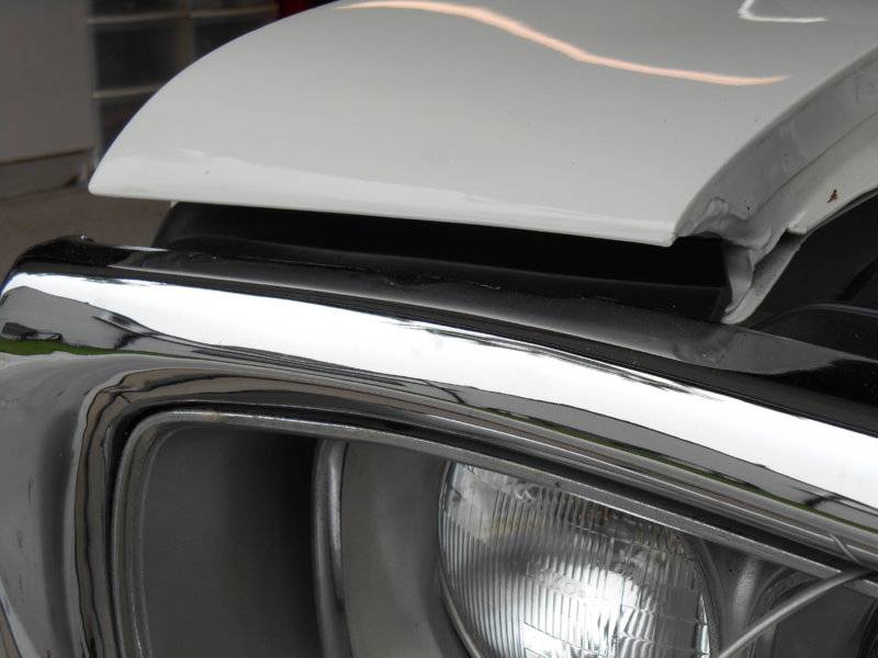

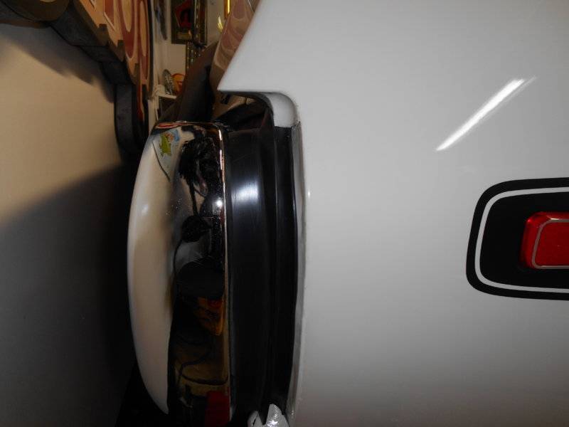

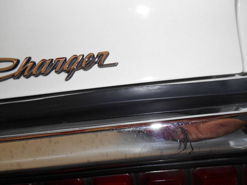

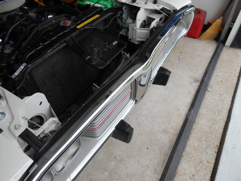

Here ya go....the close-ups don't do it any justice but its raining out so I can't get the car out for better pics. The black definitely hides any gap issues.
Pass. side front
Pass. side rear

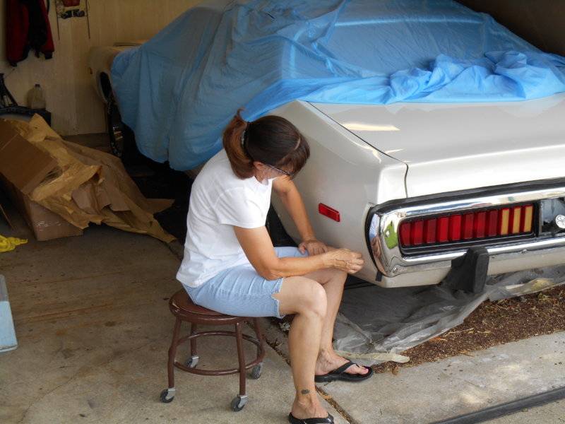

Came home from work and the wife was just finishing up doing the filler work.
I STILL think he is talking about the rubber bumper extenders tacked onto the outside of the bumpers. Hanks pics #3 and #7.
Yes, I was talking about the rubber bumpers that stick out from the bumpers on 73 and 74 Chargers. The earlier Chargers look more "neat" without the big rubber extensions. I think my "gap fillers" are OK, and will just need painted. I saw in the original post I sent where the guy painted them body color, vice the normal grey or silver color. Looked good. I may think about that (Dark Green).
