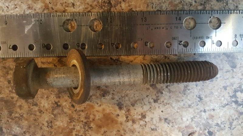

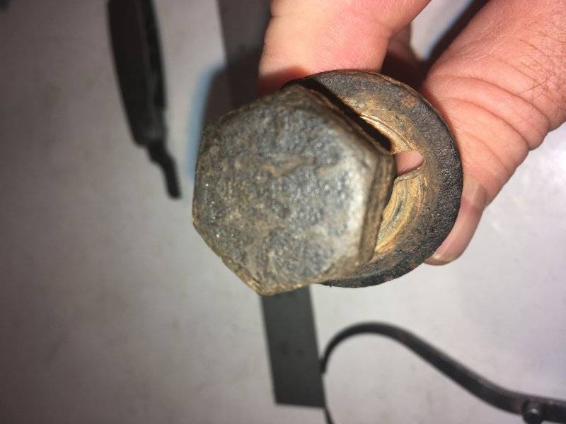

Looking to buy new Grade 8 or better k-member bolts (4) the ones that hold the bushings/body mounts, does anyone know the size?
I did a quick measurement and it looks like 9/16-12 X 5, can someone confirm?
gonna be hard to find "new" with that nose and that shoulder.
what's wrong with them? rounded?

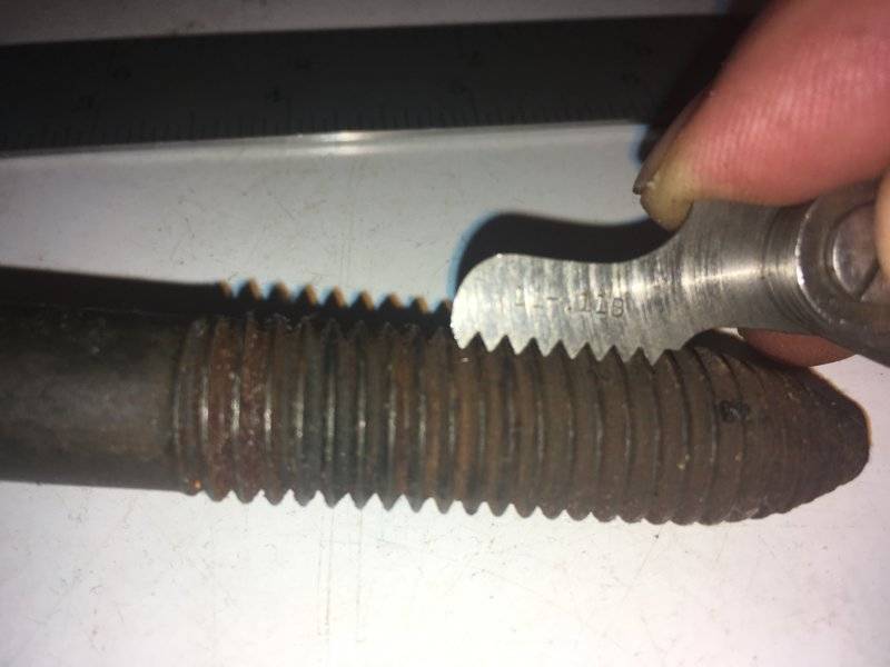

yeah not liking the threads on a few of them. i could always round off the ends, the shoulders should be ok as the sleeve goes there... From what i saw they extend at least an inch past the nut.

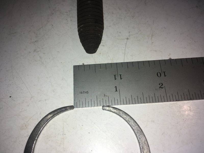

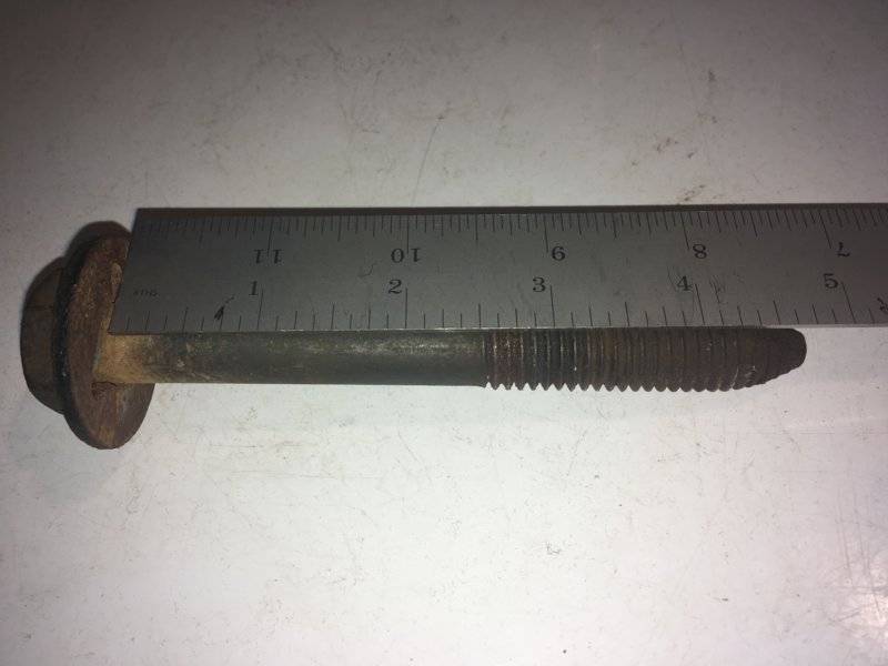

Looks to be 5/8 11tpi and 5” total length top to tip (just over 4.5” from under the head and washer. Also looks to be a grade 8 bolt.
Ps the unthreaded portion is about 9/16” and measuring the threads was difficult as they are a little rounded off too
727EFBE2-1EBD-4DCB-9FA2-EA8335AD090E.jpeg F2D45AB6-92B9-41F3-A4A3-019ADF6DE367.jpeg 9A669B0C-227F-4DE5-9BF9-826F87E90F78.jpeg 452FE1E2-27A5-4592-8869-146CA796BE9D.jpeg
What about chasing the threads with a die?
a LOT or Mopar "long" bolts are non-standard lengths (like 3 and 3/4", in stead of 3 1/2 or 4" etc)
That shoulder is also flush with the threads instead of a slightly larger dia as are most aftermarket bolts.
Grinding the nose will remove the corrosion inhibiting coating and possibly the heat treating.
You'll never see that anyway.
I may end up buying a tap/die just to be sure it doesn't get stuck, one of them took like a good week to get it out. Impact gun, heating, liquid blaster, cutting the sleeves off and a lot of quick prayers. I was looking at Grainger they have these which might work, although the thread length is 1 1/2 and the original is 2 1/8".
Or i can get a fully threaded one 5" long, i don't think it would matter, zinc coated with a lot of anti-seize.

Honestly from the distance I can't see anything wrong with that bolt. I seriously doubt you'll find exact same bolt at shops

The OP's bolt sure looks like grade 8 while the more recently posted bolt is clearly grade 5.

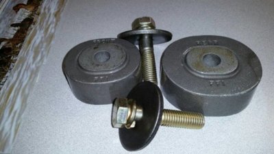

Firm Feel sells a solid k-frame bushing kit, which comes with new bolts. If you call they may agree to sell you just the hardware. I have no idea if they are tapered like the originals.

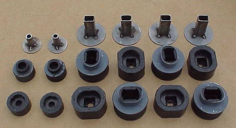

They will be much shorter with a very large thick washer as the aluminum puck is only acting as a solid spacer where as the original and the newer poly act like a clamshell (for lack of a better analogy) where two bushings lock together through the K-frame isolating it from the bolt and the frame. hope that makes sense... hope the pix help explain as well
