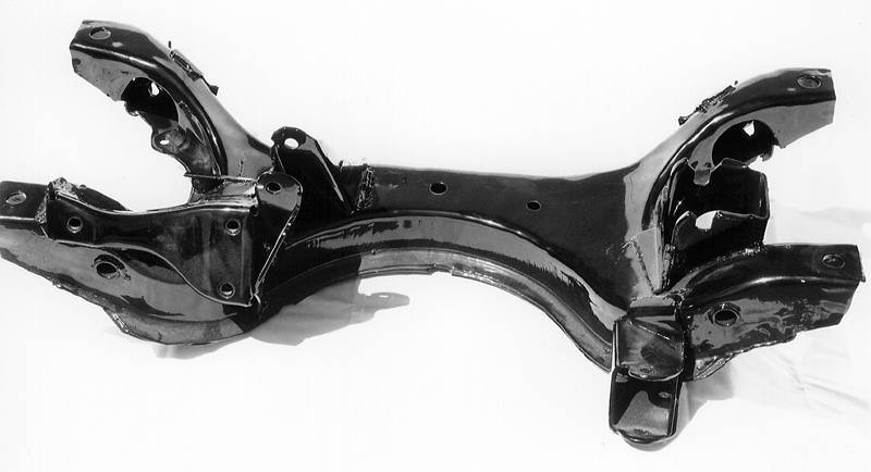

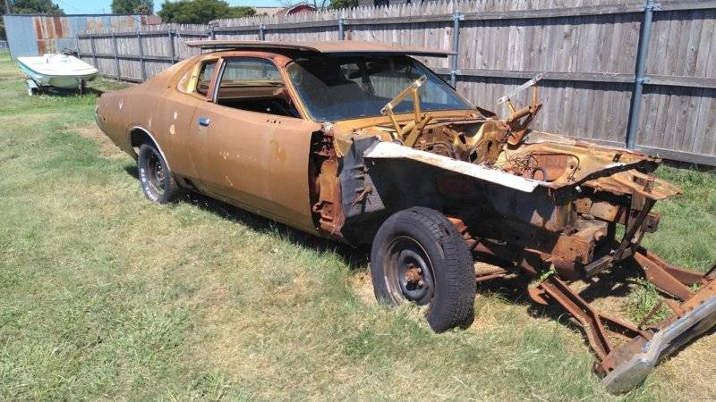

So the 74 has a different K member as I read more about my car, that leads to less parts available for suspension swaps, steering upgrades. I need any tips on what to do for a road race project, like using solid bushings, or going to another K member all together...aftermarket or Chrysler swap? Goal was to do a coilover and rack-n-pinion steering swaps, but it looks like I may have to just do stiffer torsion bars, lower it manually, upgrade factory disk brakes, some sort of sway bar and maybe a universal rack-n-pinion kit, unless someone has better options?

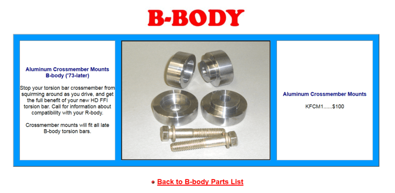

The 74 suspension is very different from all the other years before it except 73 (and there are even some differences there). Because the cars that came later weren't really sporty at all, there is very little aftermarket support for this setup. One problem you're quickly going to run into is that the k member is secured to the frame with rubber bushings that dampen the ride. For road racing, you'll want to get rid of this. Problem is, it's really hard to find the metal versions you'll want without paying a boatload. The rear springs are also isolated with rubber mounts that are hard to find kits to remove. Only firm feel really has parts for the 73-74 b bodies, and they're expensive as hell, but they do have parts to fix both of these problems. Swapping to another k member would be difficult because in 73 they switched the upper control arms from frame/inner fender mount to k member mount. Torsion bars are also unique for these compared to other mopar muscle cars, so firmfeel is the only place to go for those, too. Disk brakes won't be a problem. Sway bars are available from several places ranging in price, as well. Not too sure on steering unfortunately. Really, FirmFeel is going to have almost everything you need, and for a lot of the stuff, they'll be the only ones that have it. Unfortunately, you'll pay a premium because of that... That picture is NOT what the k member will look like, by the way. This is is the best picture I could find of the 73-74 style: http://www.macikspaintinplace.com/Pictures/1973roadrunner/1973RoadRunner11.jpg

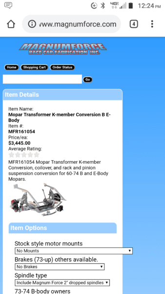

Check out Magnum force I believe they have a hole k frame setup that will plug and play in there

Firm feel in Washington state carry solid isolators for the front K-member - much better than rubber or poly isolators.
