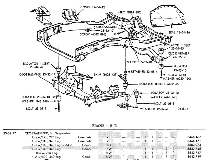

Yes, K frames are different small block to big block.
Transmission may be as well. For example a 400 or 440 will burn up a 904 fairly quickly.
So if I stuck with a 360, would one out of a ram work? Would I need to check the frames 1st?
Any 360 will fit. You will need to use the oil pan that is on the 360 in your Charger.
I wanted to add that a K-frame is a K-frame. Big and small block are the same. Only the engine mounts are different.
6pak. I do know in previous years (like my 67 for example) they are the same. And let me say I have never compared them side by side, myself. However saying that I have had many people tell me 73-4 B body are different.
And something must be since there are 3 part numbers listed. 6, sb, bb.
Can you elaborate any further? You have me curious now.
All I know is that I just bolted the 440 in. The oil pan was different from the 72 and older cars. That was it. It has been years since I did it. I think I used 400 motor mounts on a 1970 440 and bolted it in where the 318 was. Now I am curious also. I just asked a friend who put a big block in his 73 Charger. He said he used the 318 K frame. So why 3 k-frames?

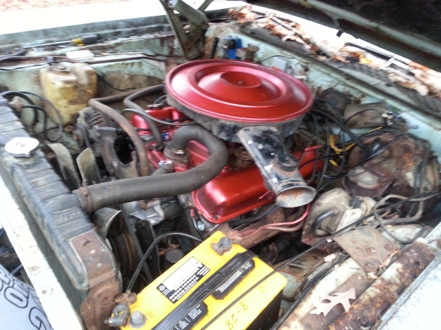

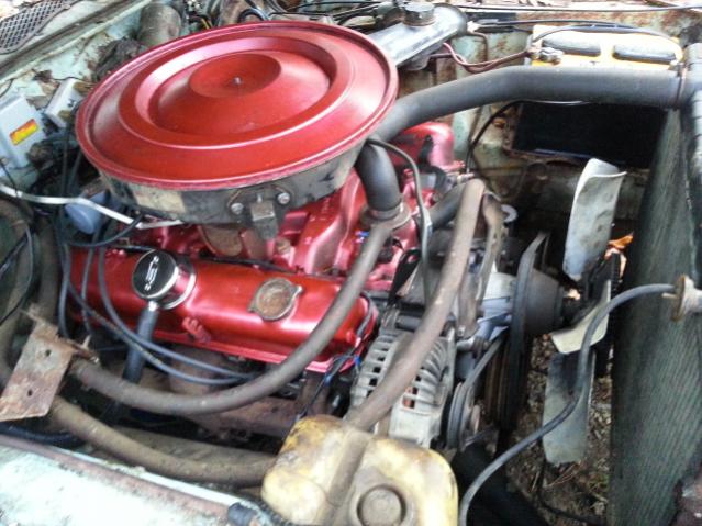

Here the top view of it.
Stock 318 Poly, 318 la Heads, 360 2bbl Manifold, 2bbl Holley 2210 Carb
Poly and LA do not interchange heads.
That's an LA motor.
What does the casting # say on the side of the block?
