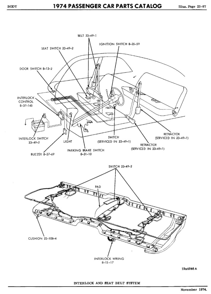

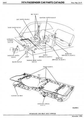

it is under the hood. Here is the page from the parts book. Right click "view image" should bring it to full size.
K thanks, will check it out.
What's the box beside the icm?

at a side of glovebox, you should get the control box... orange, is Canadian... blue is Federal USA for auto cars... white for manuals
