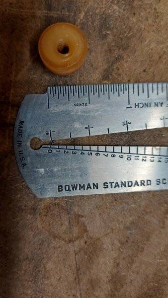

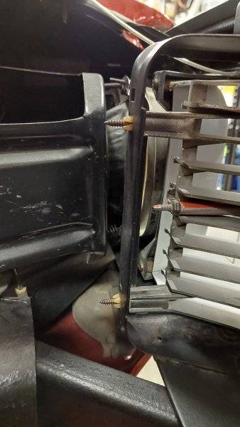

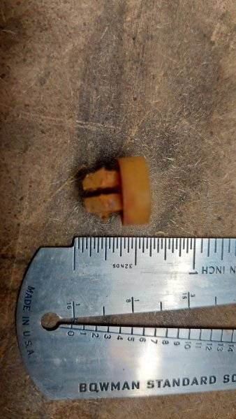

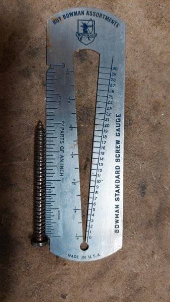

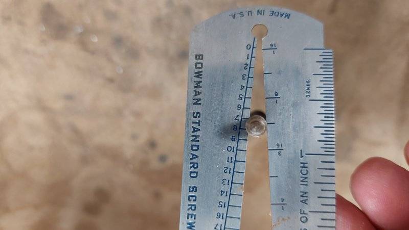

I'm pretty sure they're referring to grille, not headlamp adjusters. I have a couple left over from my 73 resto, screws and the plastic fastener that goes in the sheet metal. Let me take some pics for you. stand by.
Here you go
Grill in my case.
OK, this is a drill size and fits into 5/32 snugly. 11/64 is a bit loose. Yes 2" long by my measure but a little longer or shorter won't be an issue as I recall. But as you can see they stick through quite a bit. I've scraped my hands many times on those buggers.
