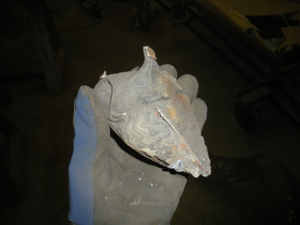

I think you're ahead of me since you've done your motor, a/c, etc.. Impressive upholstery work you did also. Just one question tho, Is this a prehistoric shark tooth? lol..

And my uncle found this guy.
