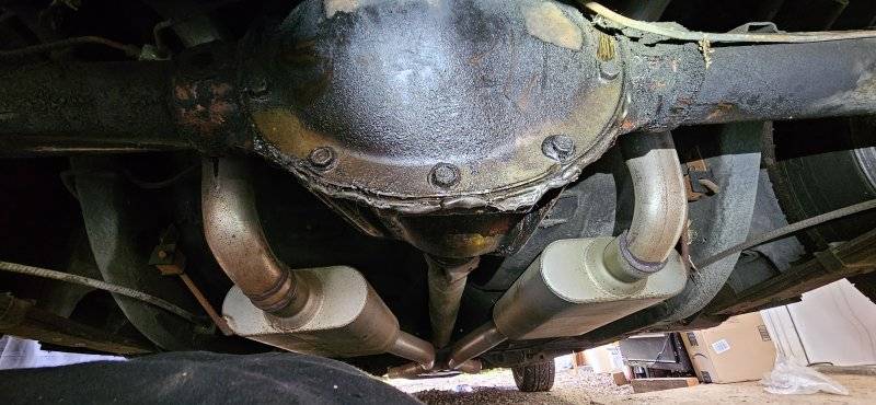

So, i'm toying with refreshing and regearing and adding a suregrip to my 8.25 that is in there now. Problem is, the more research I do, the more confused I am.

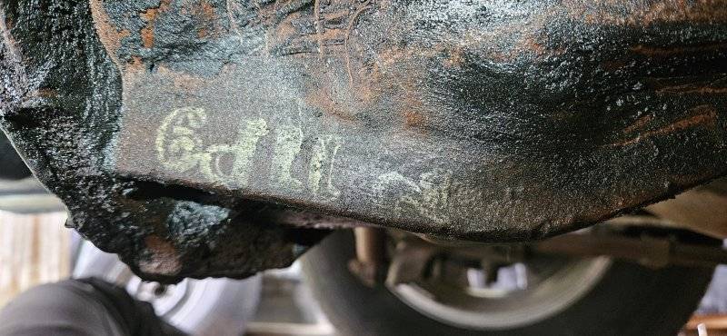

Here are my problems. Chrysler used 2 different carriers depending on the gear ratio? I know there should be a tag with the ratio attached to the cover, but it looks like it's gone missing over the years and I have no idea what gears are in there. Looking at the housing, looks like it is offset and not centered. The only marking on the housing is "2 11P9". Can't find any info on that.
I'd like to put in 3.55 or 3.73 gears with a suregrip. Is this even possible on my current rear end? I guess i want to know what my options are. I appreciate any advice in advance. I know nothing about the 8.25. BTW, I have 30" tires in the rear.

I have the same exact car n year, yes you can upgrade to a limited slip and upgrade to a 3.55. I have done it, but stepped up to a 4.30 gear set with limited slip. I run a 400 hp 340 and use it for drag racing and have not ever had a failure. In addition I did all the work myself, only thing is I had to get the pin in the limited slip machined so the axles will fit in and c clips reinstalled. I also made my own adjuster to set backlash with an large nut welded to a socket.
I did this upgrade 25 years ago before YouTube and be a heck of a easier in this day and age. My only question is the cost now versus the going to an 8 3/4 rear-end. Also you could use an 8 3/4 out of a late 60's C body, should be not that hard to find, example 69 dodge Monaco. Good luck and have fun with the upgrade.

On a final note, make sure your ring gear is the same thickness as the original or u will have to get the center pin machined so axles will fit with c clips. In addition if u buy new should have a diagram showing how much to machine off, very important for machine shop. If it's a thicker ring gear. If you get stuck don't be afraid to ask more questions, willing to point u in the right direction.
Well, as an update to this, I bolted in the 8.75 and everything lined up well! It ended up being a direct swap, brakes bolted on from the 8.25, and no drive shaft mod was requited (at least it fit up just fine). My old 3rd member and the 489 I got had the same yoke so it mated perfectly.
