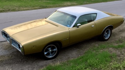

I purchased a 8 3/4 (742) axle 276 open carrier from a 68 Chrysler 300 axle (same dimensions as the C-body at 61-3/4″) for $180. My 1971 Charger is 63 from drum to drum and I have about an inch of clearance between the tires and the leaf springs. It's really close, so I may have to get a spring relocation kit...1/4" weld on spacers are tempting as I don't need much.

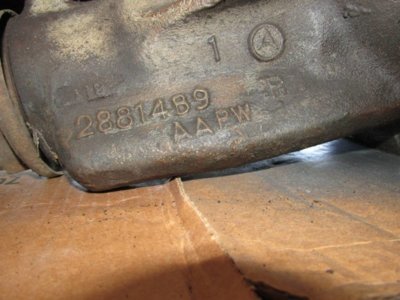

Can I get your thoughts on this? Today I found a 489 case locally with 4.56 gears (insanity) that looks super clean at $425. Maybe I go with this and swap out the gears. Do I jump on this? It's crazy clean...almost too clean?? This is the full description: 8 3/4" rear end 489 case 4.56 Sure-grip center section with large yoke. Schafer gear set, Cone-type LSD, spins smooth and free with appropriate backlash; pulled in as run condition.
Can I get your thoughts on this? Today I found a 489 case locally with 4.56 gears (insanity) that looks super clean at $425. Maybe I go with this and swap out the gears. Do I jump on this? It's crazy clean...almost too clean?? This is the full description: 8 3/4" rear end 489 case 4.56 Sure-grip center section with large yoke. Schafer gear set, Cone-type LSD, spins smooth and free with appropriate backlash; pulled in as run condition. View attachment 588340 View attachment 588341
auburn sure grip with 4.56 gears? chances are the auburn needs work, plus gears, set-up, etc. keep shopping, unless it's real cheap.
