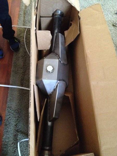

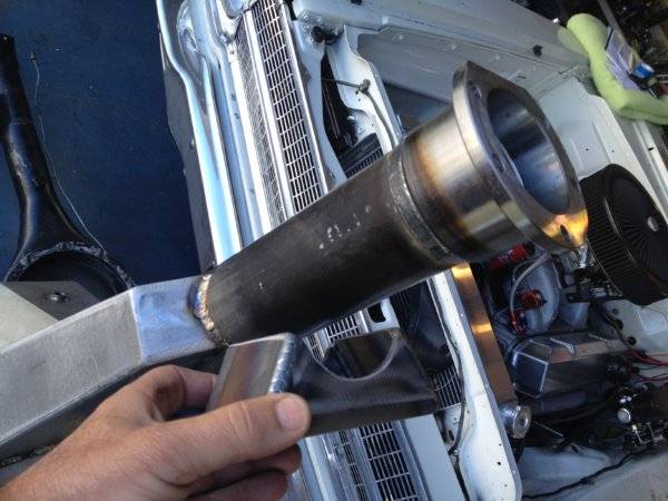

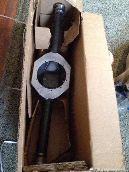

I do realize that a Dana or a 9" is most likely in my Future, but as I try to lighten the car I cant help and think how heavy this Dam Dana is, I pulled one out of a 78 3/4 Ton Dodge truck and this thing weigh's a ton, obviously it'll lighten up once all the truck stuff is removed but How Much?? anyone Ever weighed one before?? also I already bought the
"Moser Fab 8.75" and have high hopes with Mark Williams Pro Gears, and Also Now offering Service's for the 8 3/4 that just 2 years ago wasn't available, call me Crazy I guess ?? Lol
LMAO just trying to do what they say cant be Done !!

My understanding was that most of the problems with the 8 3/4 are do to the weak thin wall housing and if you ever really looked at one you'll see that it's actually 2 pieces put together like a clam shell. Now i'm sure you could break the gears on their own but is it arguable that the extra stress on the internals from axle deflection could be the root cause of the failure. Has anyone seen a Fab 8.75 housing rear break before? Cause I've not seen one! Not saying a Dana isn't the ultimate way to go but like me you already have a good starting point with that fad 8.75 housing.

Have you contacted Moser? I'd think they'ed have some thoughts about what that Fab 8.75 would/could handle? I'd be interested to here from them seeing how they sell both 8 3/4 and Dana stuff. Should be unbiased IMO.

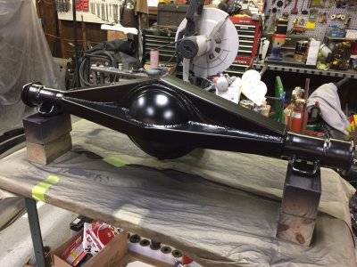

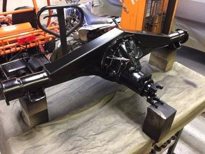

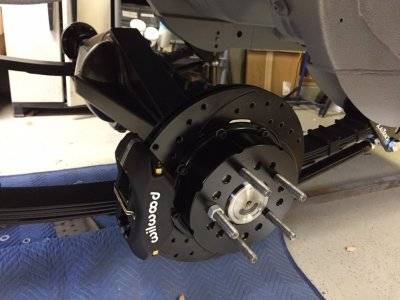

I'm running an 8 3/4 I actually bought from Mike Gaines. When I bought it I wasn't planning on making the power I am now but I think I've given it a fighting chance. Is a S60 in the future? maybe but for now the 8 3/4 is still in there.
Narrowed 8"
Moser axles
4.10 gears
Detroit Locker
Back and Top Braced
Willwood disc's
Glad to see my 8 3/4 found a loving home
GOOD JOB !!!!
Well, I guess they don't hold up to 6k launches in a 3300 lb car very well lol

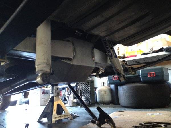

We've run an 8 3/4 with 4.56 gears in our N/SS '63 Plymouth for years (20). We've broken it twice. Once at the end of the track when I dumped the throttle to take the stripe, and once when leaving the line. Car 60-foots in the low 1.50's at 3700 lbs. It's an automatic with a Dynamic 9.5" converter on 9" slicks. My feelings about the life expectancy are more related to pinion angle, or the lack of good pinion angle. If running SS springs, even with wedges to fix the said angle...the rear end sees a flux of many degrees during a pass. We recently put Cal Trac Bars and Split Mono Leafs on it and the angle changes very little during a pass. I think it will break again, but for my budget, I'm taking the chance. By the way, both times the rear broke, we not only hurt the sprag, but we also broke our rare, '65 only tail shaft! Both breaks put us out of competition for the day. SMDH
