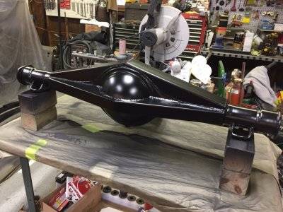

Putting the money into a Dana is probably the solid choice. With that said; while I only make somewhere around 525 hp, I do throw 3800+ lbs at my 8-3/4 on slicks, at the track, and often. It’s backbraced, runs a 742 pig with steel caps, Richmond 4.10’s on a spool and 35-spline DrD axles. Will I break it (again) someday?.... Yeah, probably. But it’s working for me currently.

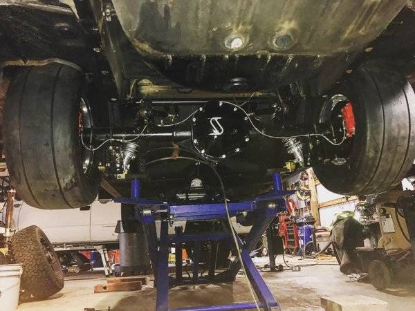

I looked at upgrading my 8-3/4", but it would have needed everything. Axles, spool, gears, bearings, back brace, and yoke. The cost added up close to what the Strange S60 was.

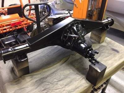

I'm running an 8 3/4 I actually bought from Mike Gaines. When I bought it I wasn't planning on making the power I am now but I think I've given it a fighting chance. Is a S60 in the future? maybe but for now the 8 3/4 is still in there.
Narrowed 8"
Moser axles
4.10 gears
Detroit Locker

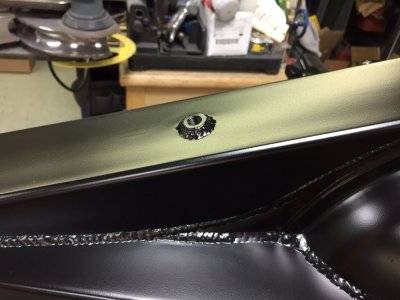

Back and Top Braced

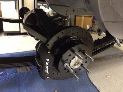

Willwood disc's
