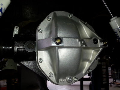

But I have acquired a Dana 60 housing from a 3/4 ton Ford pickup and I will be doing a changeover soon, as a safety measure. :steering:

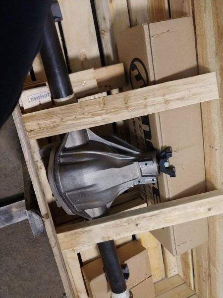

A thing of beauty...… It was $2756 for a turn key installation at the rear end shop in Fresno. I dropped my car off with the narrowed 8 3/4 in it and picked it up with my brand new DANA. I used the 11" drum brakes off my 8 3/4 and a DANA Housing out of a 2005, or so, 1 ton Dodge pickup (which they gutted and narrowed, but everything else was new.
It is all Moser parts, gears, axles, etc. 4.30 with a Spool.

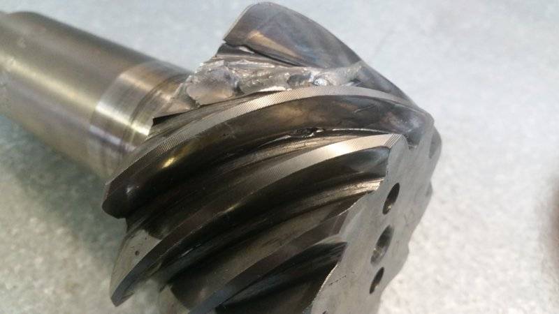

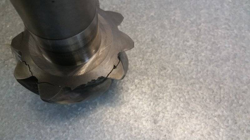

Ouch! What manufacturer made the ring and pinion? Looks as if it snapped right off at the bottom of the teeth. High rpm launch?
DVW, you have way more torque than I can imagine.
It was a no name gear. Previous Motive street gear went 420 passes. Then it bent a pinion tooth. This one only went 125 passes. 3000 rpm foot brake, 3350lbs. Actually ran 1.25/9.10 on this pass. New US Gear pro gear is going in now.
