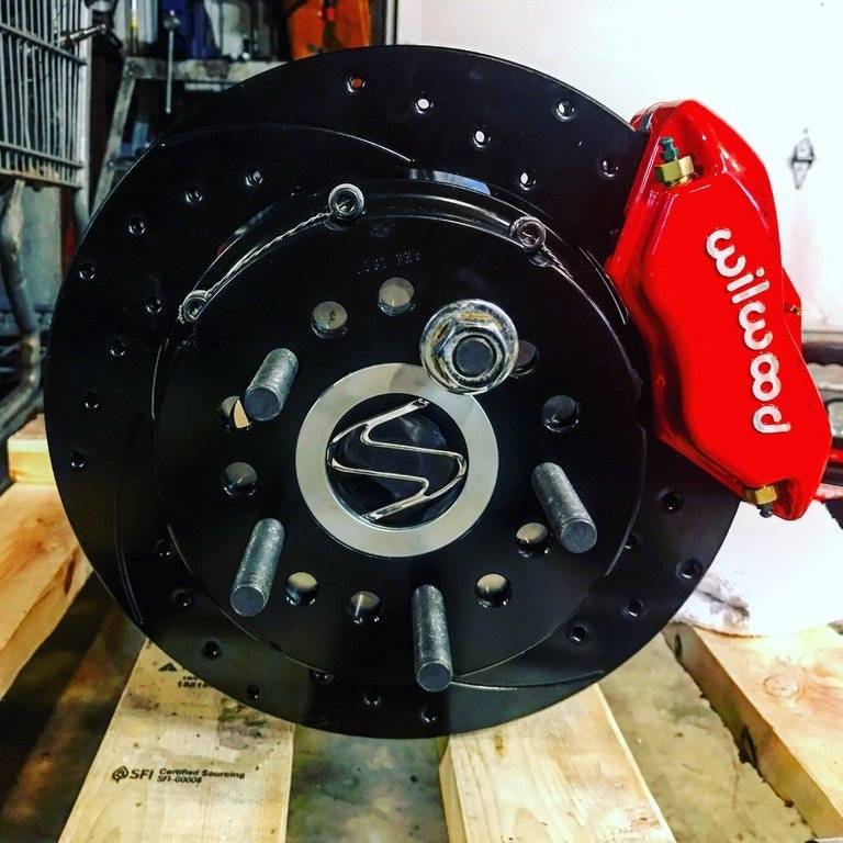

I ordered my s 60 from cass about a month ago, upgraded to chromoly yoke, and aluminum cover, add 300 if you want powder coated, add 300 for residential delivery
3 grand well spent
