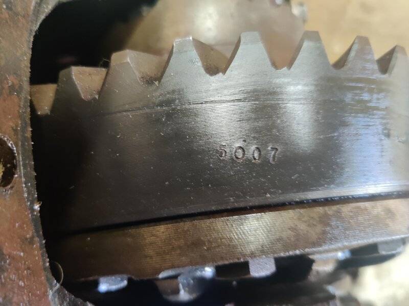

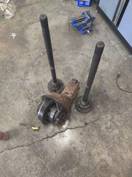

I pulled the rear end apart today to replace axle bearings and work on the brakes.
These are the gears he was running in the SS Coronet Hemi car.
Can someone tell me what gear ratio it is?
On the big ring, the first #'s are 5007

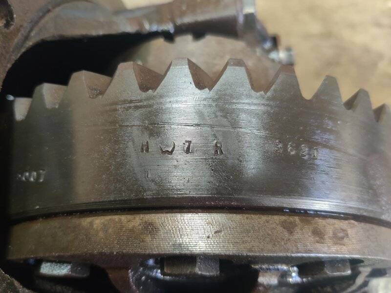

Then a space and what looks like HW7R

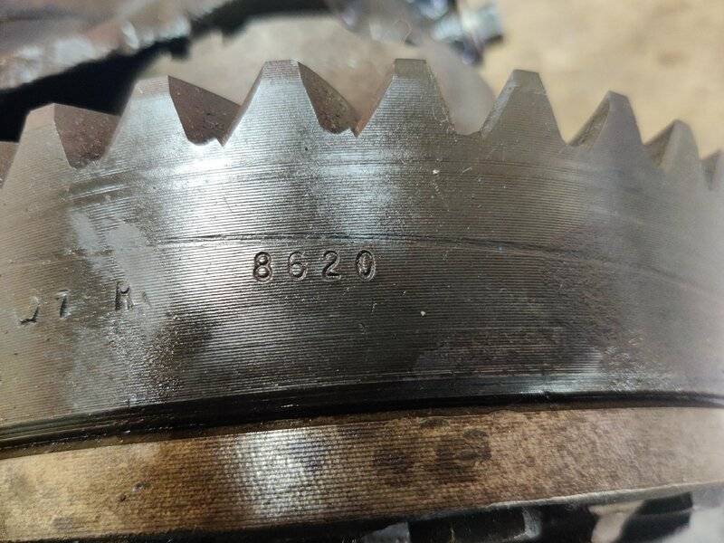

then a space and the last set of #'s are 8620

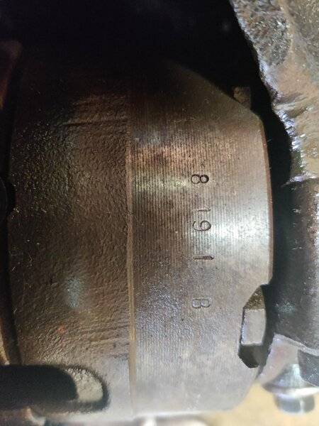

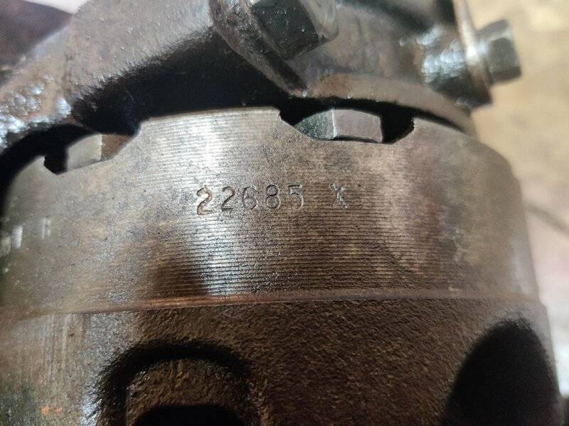

On the SureGrip its self these are the #s 8 19 1 B
space and 22685 X
Is this a 5.07 gear ratio?

22685X is the Dana assembly number for the Powr-Lok assembly.
8620 is the alloy of the ring & pinion
8 19 1 B is the date of manufacture for the Powr-Lok case. (Aug 19 '61)
5007 is more likely the ring gear I.D. number from the manufacturer of the gear set. It looks like an aftermarket ring & pinion. The ratio is probably not stamped or marked on the gear set. You'll have to do it the old fashioned way by counting the teeth. :thumbsup:

It is an aftermarket gear set. He changed it when he set the car up to run Super Stock. Could the date be 71 instead of 61? this is a 1966 car.
That type of differential case wasn't used in '71. A '71 or '72 model year sure grip would have been the Borg-Warner cone clutch style. Since it sounds like it was used in a race car, it was probably attained from a donor third member back in the day.
