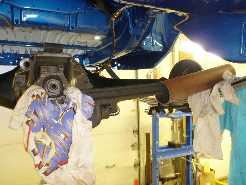

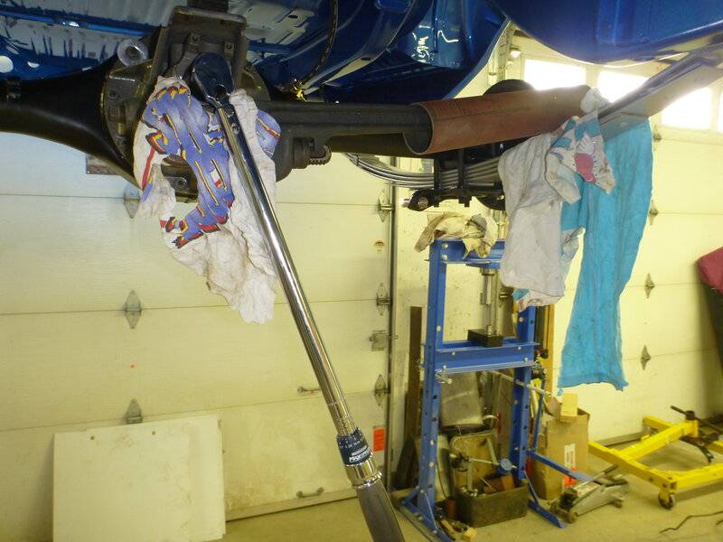

I put all my 1/2 IR impact will give it using red Loctite on the threads.....never had a problem in over 30 years of building them. And yes, bearing preload is MUCH different.
