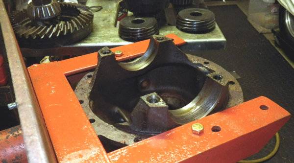

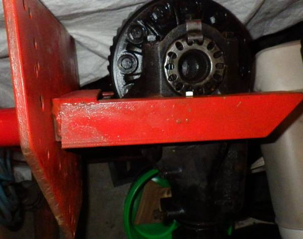

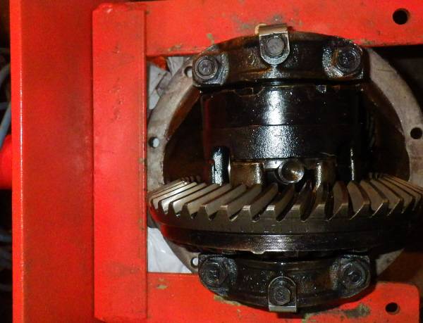

Just three pieces of 1/4" angle iron welded together and bolted to my, Lol, "any block" engine stand plate. I did notch a bit for carrier adjuster install as I was a little tight on the width.

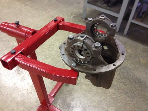

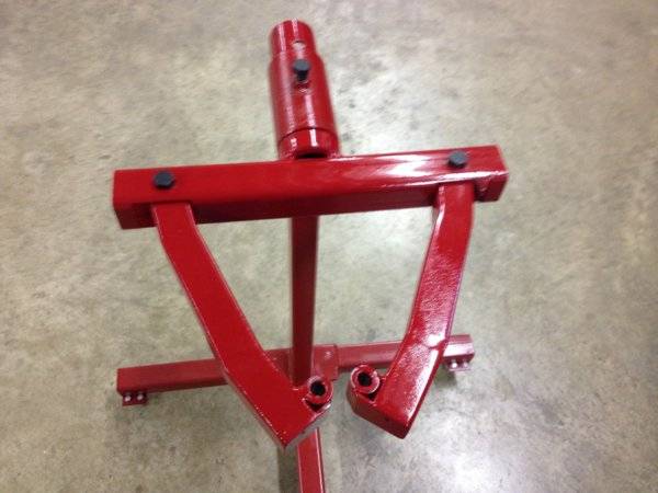

Here’s one I made, fits differential housings, hydraulic pumps, transmissions, etc. Slips in an engine stand base, fully adjustable. Made from scrap round and square tubing plus some bushings I made.
