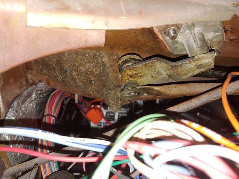

I started by removing the driver side wiper arm from under the factory 67 setup. It turns out that the dakota arm and the factory b body arm are the same length. You will attach the Dakota arm to the wiper pivot with the bushing that has hole all the way through and then use the factory metal clip to lock it in place. The other end will connect to the motor with the standard pushon wiper bushings you can still pick up at the auto parts stores. No more fancy $35 2 or 3 spd bushings needed.

For the motor you will take the firewall bracket or cardboard with the pattern and transfer the holes to the metal plate. You want to keep the wholes on the center pivot to a tight tolerance as the rubber boot works to seal the hole from water intrusion. Here is a pic with it installed on the firewall. It takes up a whole bunch less place than the original motors.

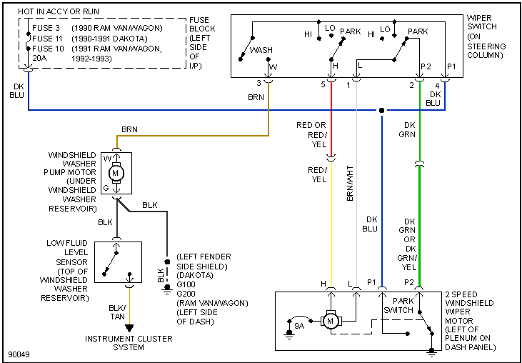

I used this as a reference for the motor wiring.
I got tired of jacking around with the factory switch and ordered a 75228-03BX Cole Hersee Rotary Switch for this setup. The new switch works excellent with the Dakota motor and wires up like the diagram. I'm sure someone with more knowledge of the inter-workings of the factory switch could figure out how to make it work but if you go this route its probably a better idea to just buy the CH switch and save yourself the headache.
