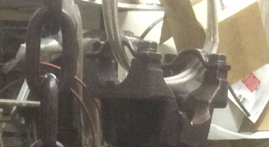

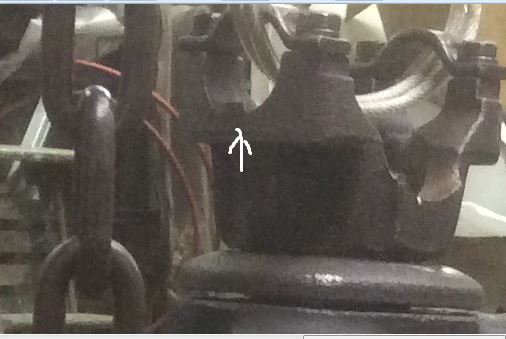

In the past you gave me 3 and 5/8 in for the 1330 tab to tab but I don't know what that means. And I didn't get the cap size for the 1350. Really appreciate your help. Thanks, Dave
Maybe this helps......
Your looking at 1330 yoke where the cup is held. Note the straps I looped a cable to lift rear. You'll notice square rising from where cup rides, there's one on each side of yoke to center cup and hold it in place. I call it a tab. same pictures, one has arrow pointing totab.
