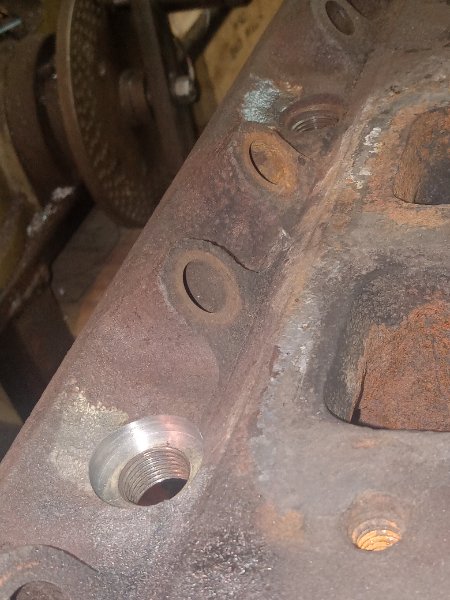

I have some 452’s here with the bump, but it’s machined out so a normal J series gasketed plug fits no problem.
It would seem that the heads where the bump hasn’t been partially machined away(and have no gasket sealing area) are the ones that use the tapered seat plugs.
If a J series plug won’t fit, use a TS plug.

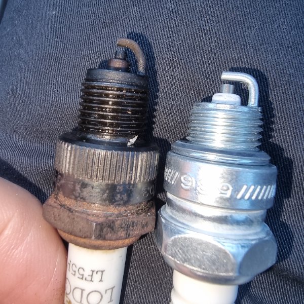

I bought some RJ14yc plugs. The reach is a bit less than what I had in the 906 heads. Just wondering if that looks right( they are listed at 9.5mmm reach). Did you have the heads off and checked the length by any chance?

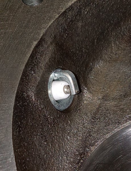

View attachment 1962963here's the 452 after machining with the plug installed medium tight.
That's exactly what I was hoping to see, thanks for posting this. I was worried the RJ12YC plugs didn't project enough into the chamber. It seems the old heads had a longer reach ( you can see in the pics) , more like 1/2', which confused me.
If you go to your local parts store, and ask for Champion spark plugs for your old Mopar, they is likely what they specify. Or RJ12YC, which I find is a little cold for the type of driving my old Mopars see (mostly cruise nights and car shows).
9.5 mm [ 3/8" ] reach plugs were used in Chrys heads. There were also 1/2" reach plugs [ post #26? ] but not aware of them being used in Chrys engines.
Yes the 1/2' plugs were what was in the 906 heads that came off the engine before pulling it down which made me query the shorter reach plugs.

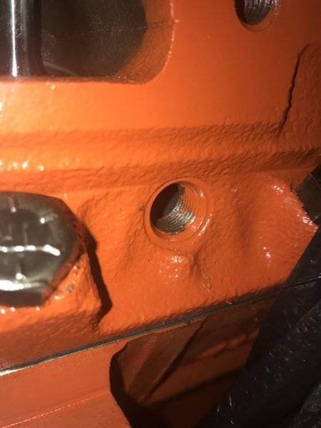

I always thought the difference was the casting date. I've had many 452 heads and every one I've seen cast in 1978 had tapered seat plugs, including in passenger cars.
Best way to check is take your finger and feel if its cut flat at the outside or a taper.
