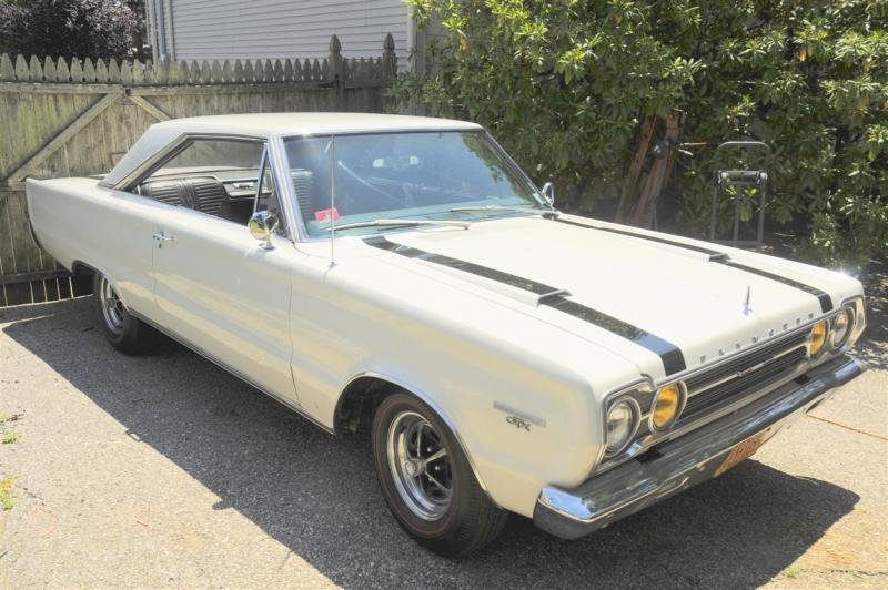

Question ? , what is the maximum safe valve lift on a 67/ 440 -915 head in its stock form.thinking of possible cam change and didnt want to pull heads.and i dont want coil bind.nothing wild something a step or to up thanks mopar gods

Rather than focusing on lift you should focus on the LSA as that more or less decides the power band of the engine. I'm running a .455" lift cam in basically the exact same car and it runs high 12's in the 1/4 (440 with 10.1:1 CR). Any cam much over stock will require a valve spring change anyway.
