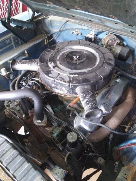

My all original 67 R/T survivor purchased from the original owner in 1984 has the dual snorkel air cleaner. The red version 440 Magnum pie plate is all peeled up but I still have it. I'm just now getting it ready to roll after 26 years of slumber in the garage. The brakes are rebuilt, gas tank is new and I'm preparing another 4327s AFB before I rebuild the original. After I get it started and rolling I'll get to whatever else needs attention. 20230107_120847.jpg
