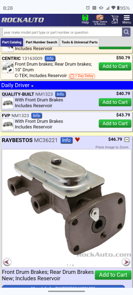

This one definitely will:
You can get a conversion block and lines on eBay.
A dual reservoir master cylinder is a safety improvement over a single pot.
