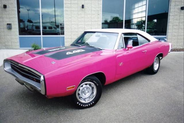

Here is a 70 Charger with Dual sport Painted mirrors. I am sure members will post thier cars. @chargervert probably has one that does and knows the code...

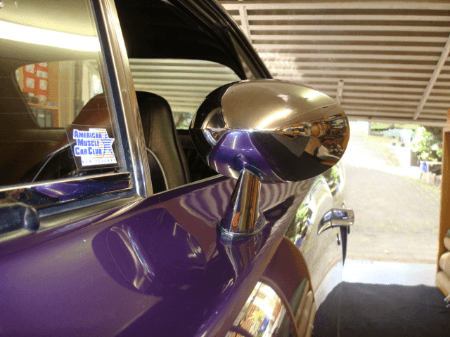

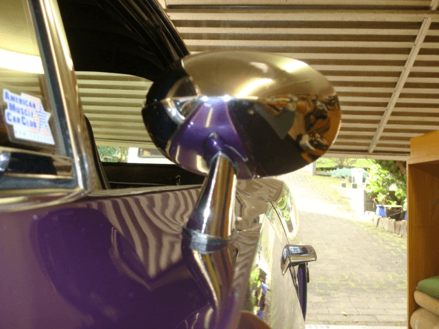

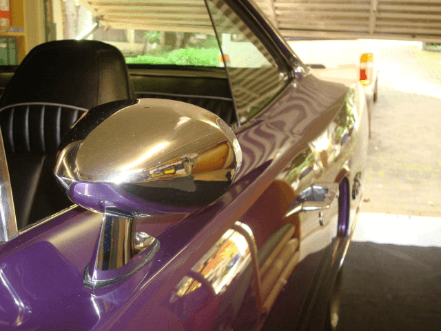

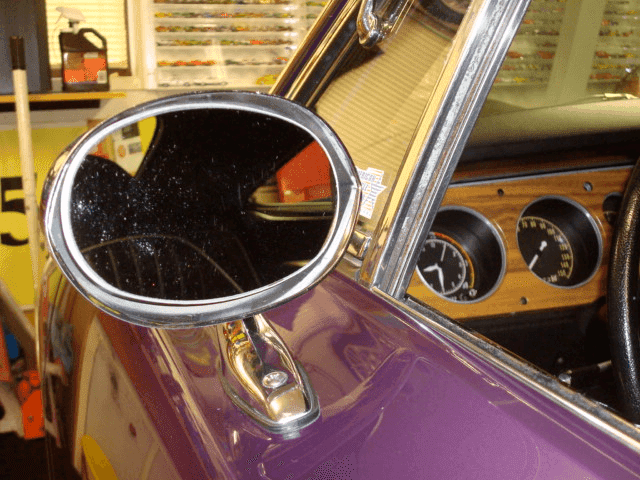

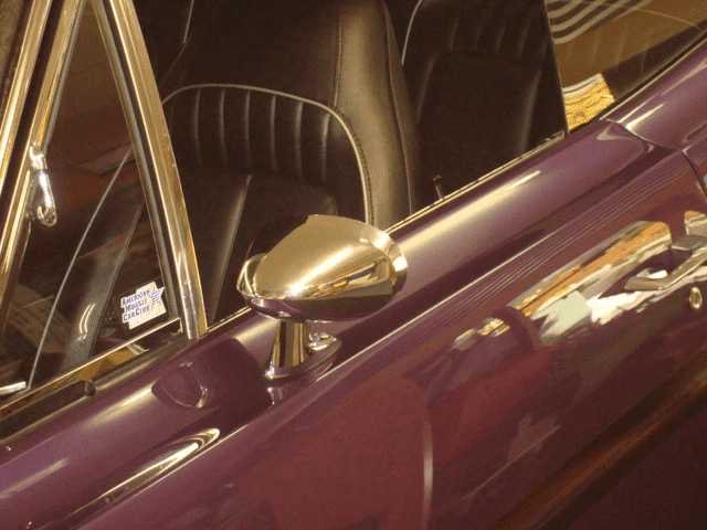

FBBO member Darius has them on his 70 GTX.
Those Mirrors are 70 E-body ONLY not 70 B or A-body. The 70 B-body and 70-up A-body are the same mirrors.... The only difference between the B and A body between models is the remote cable length on cars that have a wing window the cable is short and the cars that have all glass the cable is long.....

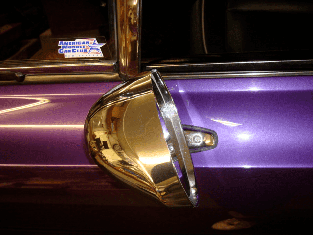

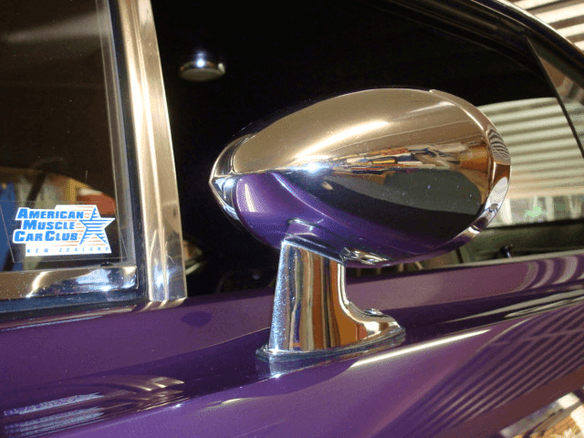

My mirror has a different pedestal to the E Body. I'll dig out some closeups later on.
The a and b body version bolts on to the top of the doors. The later b body and e body ones bolt on to the side of the doors. Different pedestals

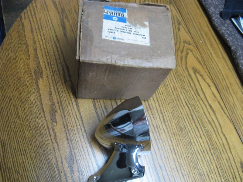

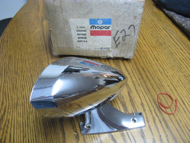

Here is a set of NOS 70 E-body mirrors... note the bases how different they are. The "heads" are the same. 1st pic is Passenger side 2nd is Drivers side remote...
