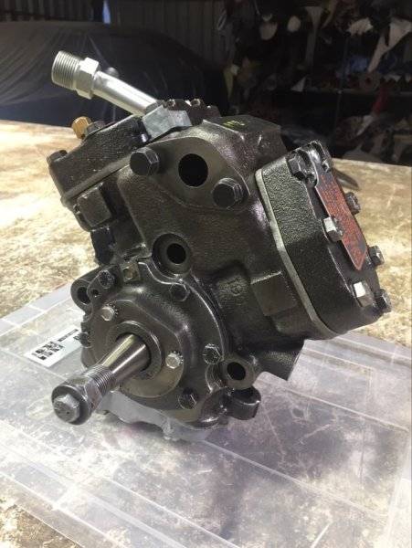

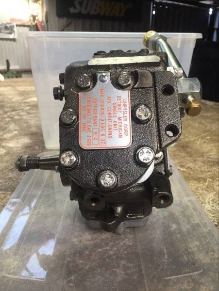

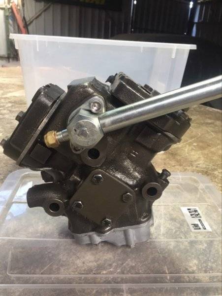

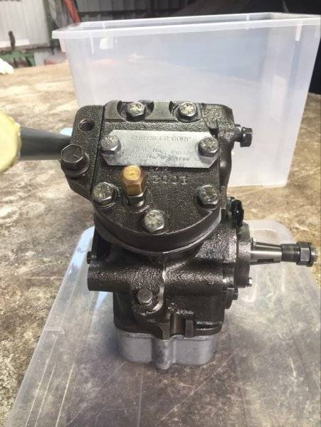

Finally finished my air conditioner compressor it took me a fair while only because i got carried away but what a great way to learn how these units work as i had no idea about A/C prior to building this system i've built everything from the under dash box to the compressor.(warning)Evil bay is shocking once you start, i couldn't stop buying genuine nos parts the only remaining original components are the block, head caps , front crank retainer & bolts every thing else is pretty much NOS. The list is new crank ,new thrust washer,new oil pressure ball & spring ,new head gaskets & seals,new pistons, new reed plates, new oil pump, new sump ,new R134a o ring seals, new suction filter, new crank seals, new adjustable PRV valve, new tag ,new bearings, new clutch field coil The unit was pulled down cleaned then coated in a high temp clear i know it's not factory but i liked it that way sort of shows it off better than a black block of steel.The unit was put together using Ester 100 oil so i can go either way with the gas R12 or the newer R134a. The unit should blow cold air for another 50 years

1969 unit

Ebay for most nos parts as they don't reproduce parts but the seals & bearings are made new
