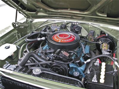

I have been getting conflicting information if the a/c pipes that run along and in front of the radiator support and the pipe running from the condenser to the drier are supposed to be painted ? As well as the hood spring , release lever and latch. This is on a 68 Charger R/T.

This is 69 but will give you a very basic idea. 1968 lines route differently

Look at the circled ends of the same line. Painted and plated on same line, is this correct? Is this photo of the Hoffman’s 69 RT convert?
There will be both painted and plated hard parts on same line.
And , Yes I think this is the Todd Hoffman built car . He sold it a LONG time ago
I've owned this car for 42 years, removed the A/C back in 1978 to lighten the load for racing and didn't have the sense to keep the parts. Now that I've accumulated all the correct parts I wanted to make sure it is correct. I do remember it looking very much like the car that is green, but I wasn't absolutely sure .
