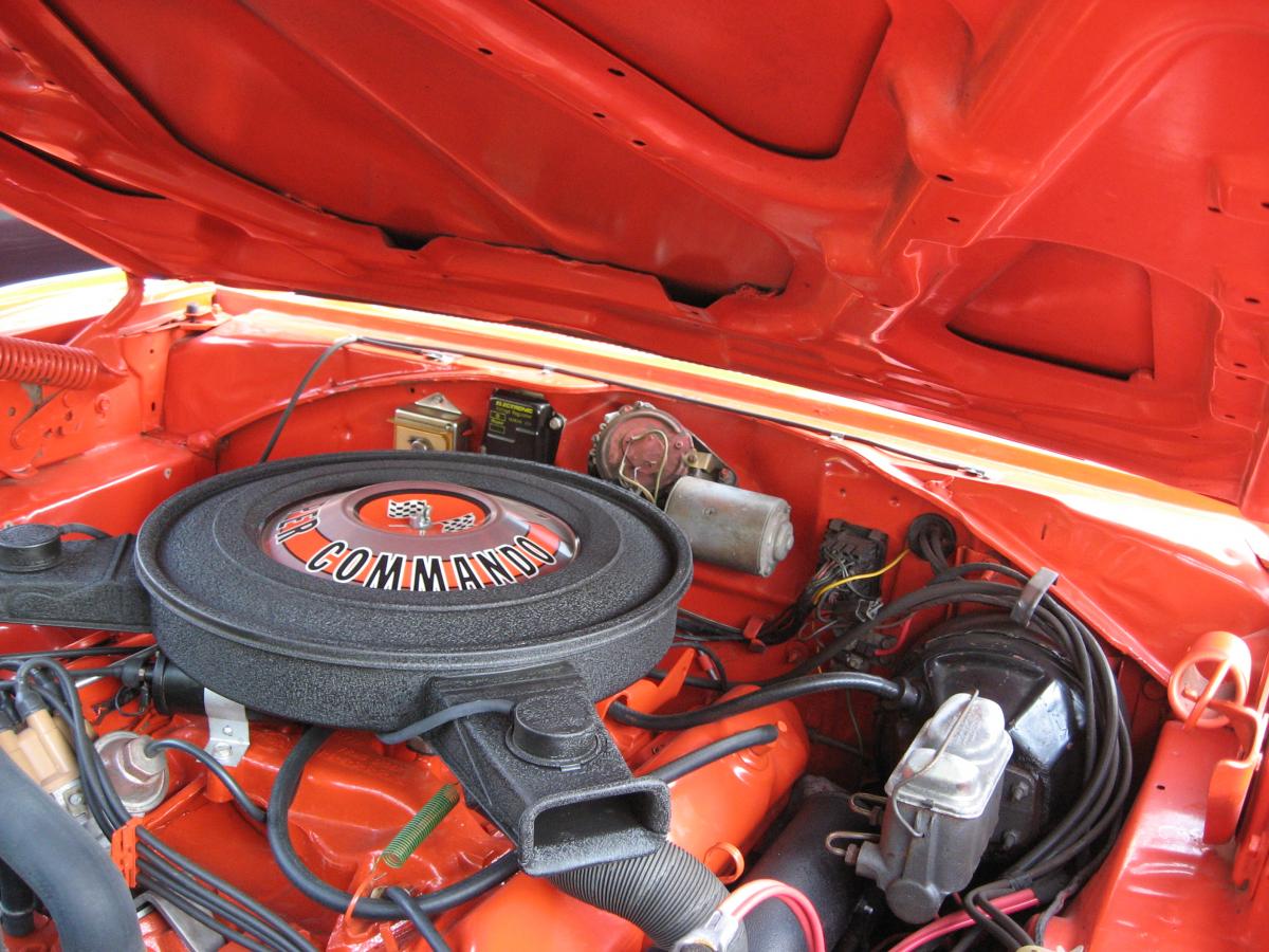

Hinge and springs are body color. Depending on the year, the wiper motor is different "colors". They were NEVER painted black unless it's a 2 speed motor. The 3 speed (or "variable" speeds) weren't painted at all. They were part "natural", and part "CAD 2"
This is a pic of an original 69 superbird.
Hinges painted.
Wiper motor is.... Au naturale'!!
Yup!! mine's a two-speed! oops!! :grin:
