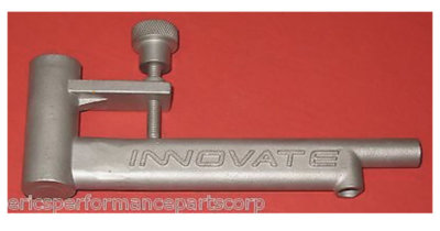

This is the wideband O2 sensor site.
https://www.innovatemotorsports.com/products/db.php
this is the tailpipe sensor
