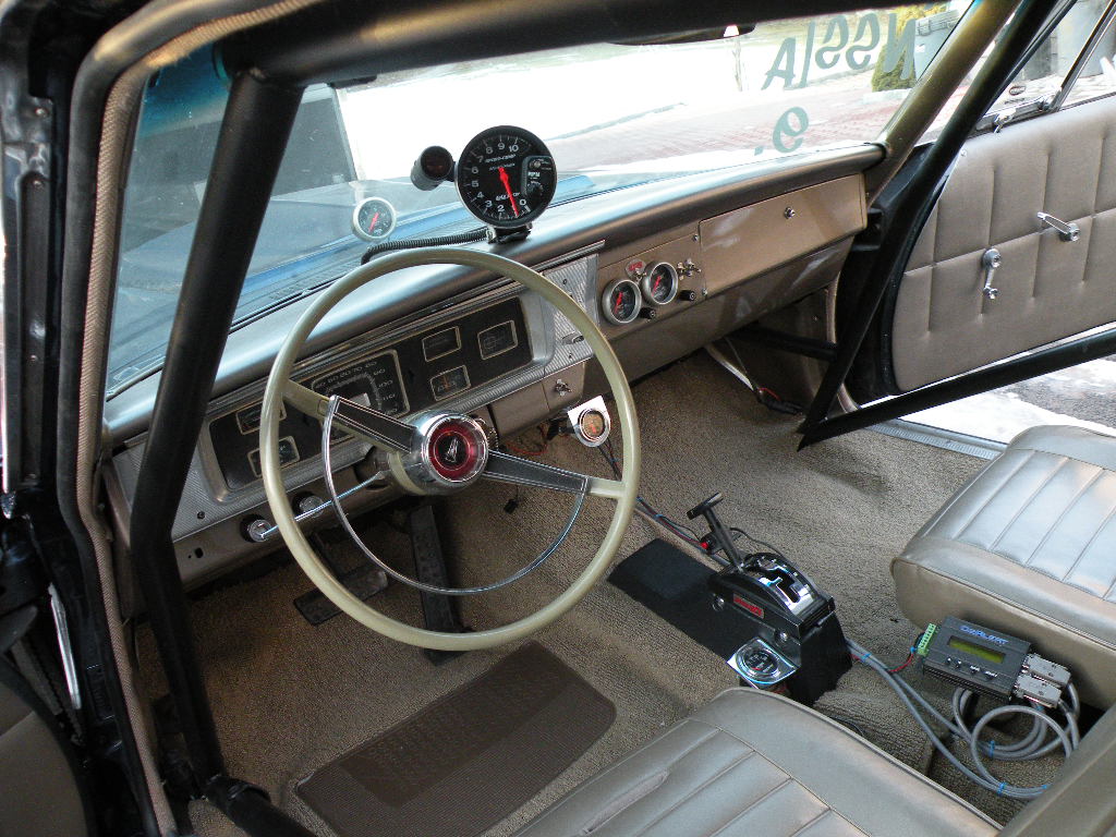

heres mine mounted. you get what you paid for.

Hey SUPERSTOCKRACER any chance you could post a little video of it in action?
Sundance, it doesnt work like that. you have a few ways for it to startup. Either manually or a desired rpm.
Once your through the run you hit mode to end the recording or let it end on its own. Depending on how many minutes you want it to record.
No fancy LED lights to get you to buy it.
After the run, download on to your laptop or PC and review the run. makes tuning your car a breeze. I picked up .3 by fine tuning my cars with it.
