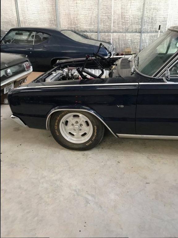

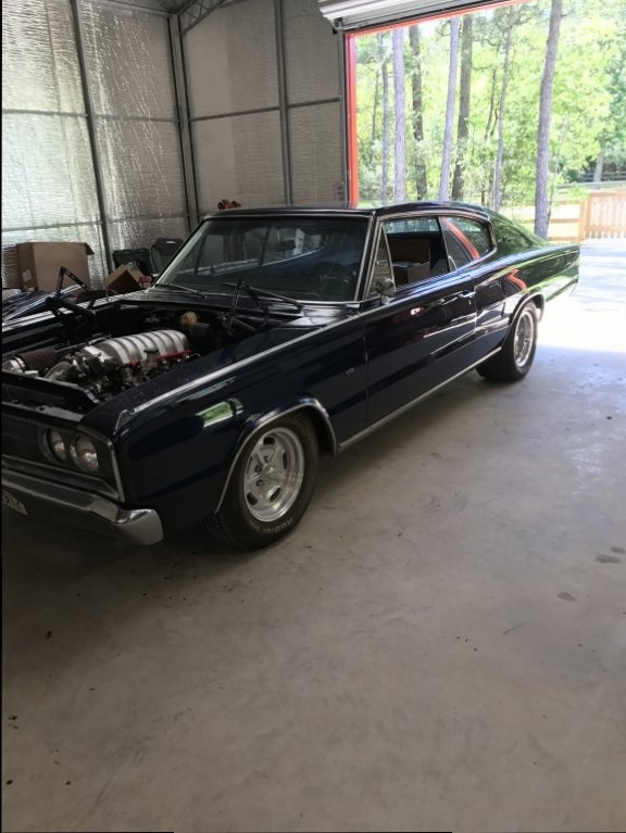

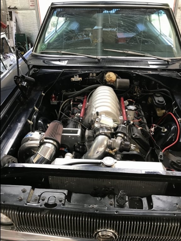

Looking sweet. Keep the car **** coming.

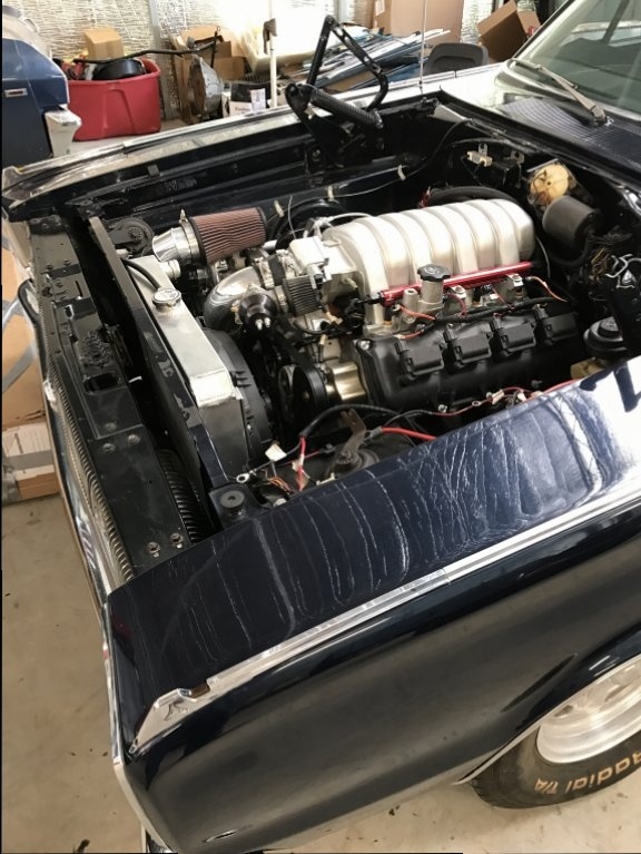

3rd generation Hemi
426 stroker
K1 crank
Wiseco pistons
K1 rods
8.8 compression
Ported 6.1 head
Ported intake
Fast xfi
92 mm throttle body
Tti exhaust headers
Tti header back
Custom ground cam by me
T trim vortech using srt jeep bracketry
Four speed gearbox
391 gears
Changing to injector dynamics 1050x injector. Running 93 pump No more e85 plans for me
Will never see the track though
I just can't trust my eyes enough these days to do it

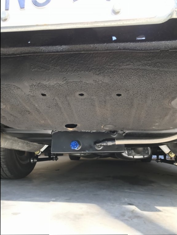

I built a sump
Baffles inside it also
Used a new replacement tank
Running a complete aeromotive fuel system
thought that I would post this to bring it alive again
