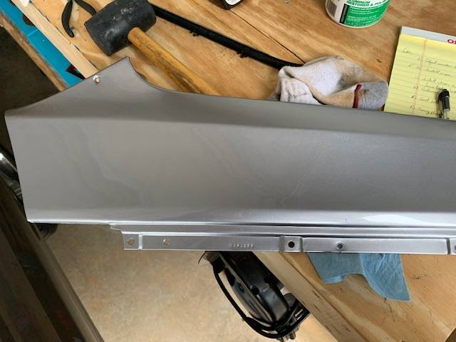

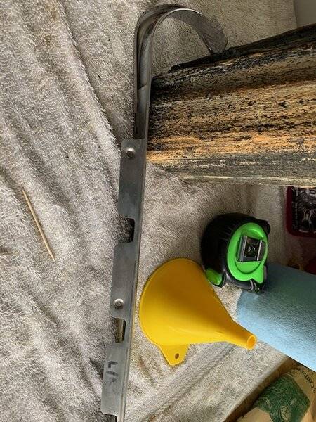

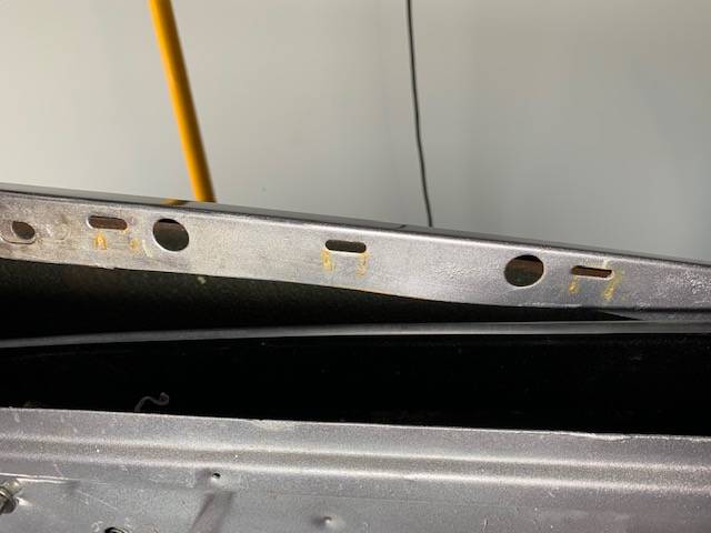

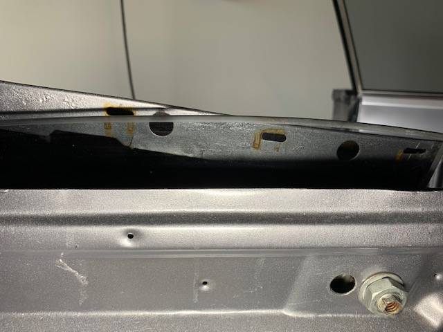

I am trying to get the interior rear upper door panel installed in my 69 Coronet, I am at a loss as to how to attach this and could use some guidance. The upper door cap/sheet metal has the window felt already attached( ist picture). There are matching holes through the door sheet metal (2nd and 3rd picture) but nothing behind the door sheet metal/ frame to screw into to secure it in place? Is there a flat piece of bar with matching holes that fits behind the oversized hole or do I have to locate some type of speed nut/clip to put in each hole? This would take a long tapped clip if that is the case, but would seem reasonable. I have looked for a clip type but no luck...any idea what they are called and where I could possible get them? I looked through the classic catalog but can't find any reference. I could use some help and will buy if anyone has what I need. Thanks, Mocajava

If you are referring to the "Window Fuzzies" on the outer skin, they were originally attached with staples thru the elongated slots. With new felts, you likely have to use screws to attach them. The coarse metal screws go thru the felt, and into the elongated slots. Make sure to use a flat head (countersunk) type, similar to a wood screw to ensure it will hold the felt, but not sit too high to scratch the quarter window.

I have to correct myself, I know how the large panel above attaches but it is the external trim that would be attaching to the round holes in picture #2 and 3. THAT is the area I need to find clips/ nuts for. I have included the pic of trim for a reference below.
Thanks Mr. B and 69Bee I also had fun with the window felts and ended up riveting them in place with stainless rivets to keep anything from scratching the glass. I corrected my post above and hope to get an idea of where I can get the hardware from YOU experts to attach the external trim to the inside door sheet metal! Thanks again

It looks like my original inquiry was side tracked. I already have all my fuzzies in but could use some help determining what and where I can get the clips that hold the exterior window trim (first picture) onto the interior top edge of my quarter panel sheet metal (2nd picture). Thanks ahead for looking
2nd picture....I hit the post button too early! There must be a clip that inserts into the 5/8" holes.... WHERE to get them and description is what I am after. Thanks again

IIR when I did my 68 R/R ( looks similar ) I used something kin to a liscenes plate plastic push in for lack of a better description. They make different sizes for round or square holes.

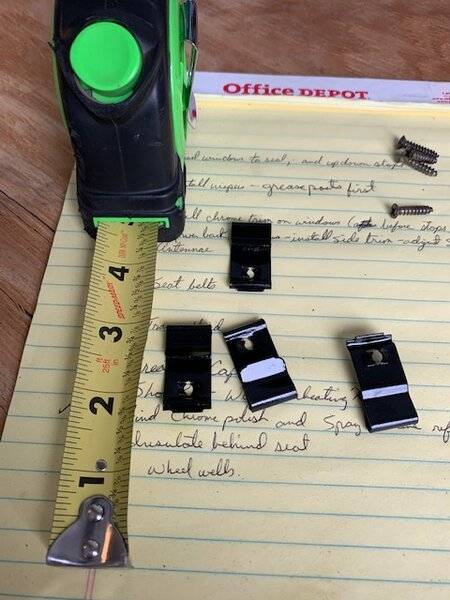

I decided to go through EVERY box I had and found the clips that go in there! They are a very long speed nut type for a#10 phillips head screw. Cleaned them up and painted them and ready to go. Unfortunately, I have to remove the window to get the darn things installed and the trim on....I hate doing things twice! Thanks for the help gentlemen, I'll try and take a picture of them to give you a reference. Mocajava
Here is the picture of the speed nuts I finally found that allow me to attach the exterior trim to the interior door panel. I just wanted to bring closure to this thread and give anyone interested the information. Thanks for all the suggestions and help gentlemen.
