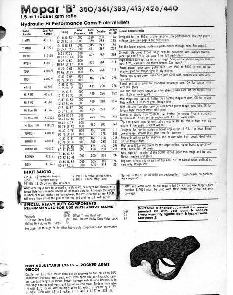

I see on the Hughes website the 440 cam made 415hp, not sure about the other mods but going by the picture it went with headers, aftermarket intake and 4-barrel carb.

Have a look at any of the descriptions of these cams with the silly names, Bootlegger, Mother Thumper. They all have a number of things in common: tight LSA & lots of exh duration. And the companies that are honest in their description say they need COMPRESSION. The large overlap these cams have produce a raspy exh note. Great for sound, not so good for performance.
Lunati Bootlegger. Almost identical specs to Hughes. 232/244 @ 050; 107 LSA. Description says choppy idle [ if you are lucky ] 3000 stall, 3.73 gears and 10+:1 CR.
These would be a tq killer in a low CR engine.
Erson cams has this WARNING in their cam catolog. The warning about excessive duration is ONLY in the BB Chrys. No other brand has this warning.

Get some glasses. I NEVER said the cam companies were wrong. I have given three examples Crane, Lunati & Erson of rough idle to support my statement.
I said Hughes were wrong & they are not a cam company. They sell cams they buy from other people.

Once again you got it wrong. Get some glasses. There plenty of people running these type of cams with 10:1 or higher....& not using/needing race fuel. Maybe someone will chime in. My quotes about 10:1 CR etc came from the cam companies. I am quoting their info, but for sure, I agree with them.
You can put any cam in any engine; that does not mean it will give the desired performance. Low CR engines need more care in cam selection.
