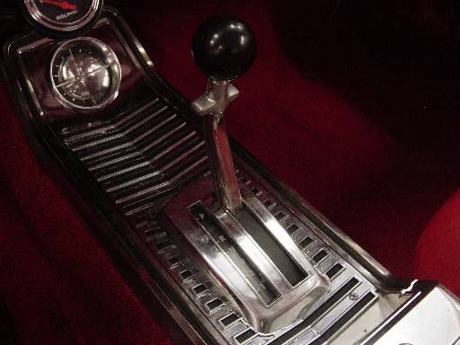

First pic, is what the shifter itself looks like. The shift ball is pushed down, to go through the gears. It's spring loaded, and off a rod that's located inside the shifter, a short pin locates the various shift points, along the gate.

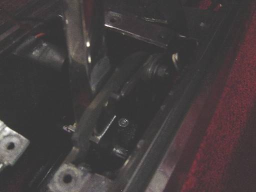

Second pic, is looking at the shift gate, the pin, and the trip arm. Trip arm is weighted on the front end (that's not in the pic), and rests on the micro switch arm. In the pic, the shifter and pin are in neutral. If it was in reverse, the shift ball and pin goes down, and when released, the pin contacts the end of the trip lever, that activates the micro switch.

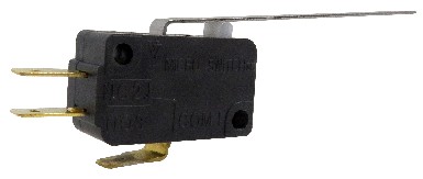

Third pic, is the same type micro switch used.

Might just be the switch itself. Doesn't work properly after setting but clears up when used a little bit. Just a guess.
Appreciate that, Shorthorse! Could be right, switch button hanging up a little. Get some run time on it, might straighten up. Had to be certain, for clearance, and operate the way it needed to. So, fairly sure no issues there.
Thanks, guys!
I have used those type of switches before. Was not very happy the result was to remove it and used a different type which was a ball style
Thanks, bearman. With this shifter, I felt a little limited on what type of switch could be used, and mounted. I'll stick with it for awhile, to see how it holds up.
