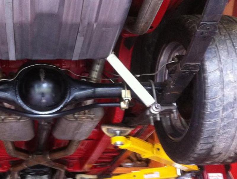

Thanks for the pictures and description of your sway bar fabrication Kern Dog, I like how that looks! Hadn't even thought of the sway bar aspect yet, still in the tear down mode. With the weight of these "boats" we drive I remember how my 68 SuperBee would sway in the breeze while cornering (I'm sure the extended shackles didn't help!). I will need to plan for some type of assist and you have given some very good advice and real experience for me to think about. Another post for my files as a referrence for later work. Thanks..
That picture is actually of the Addco bar, the 7/8" bar that I removed.

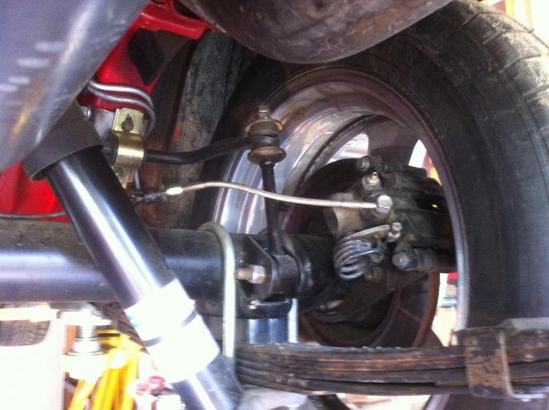

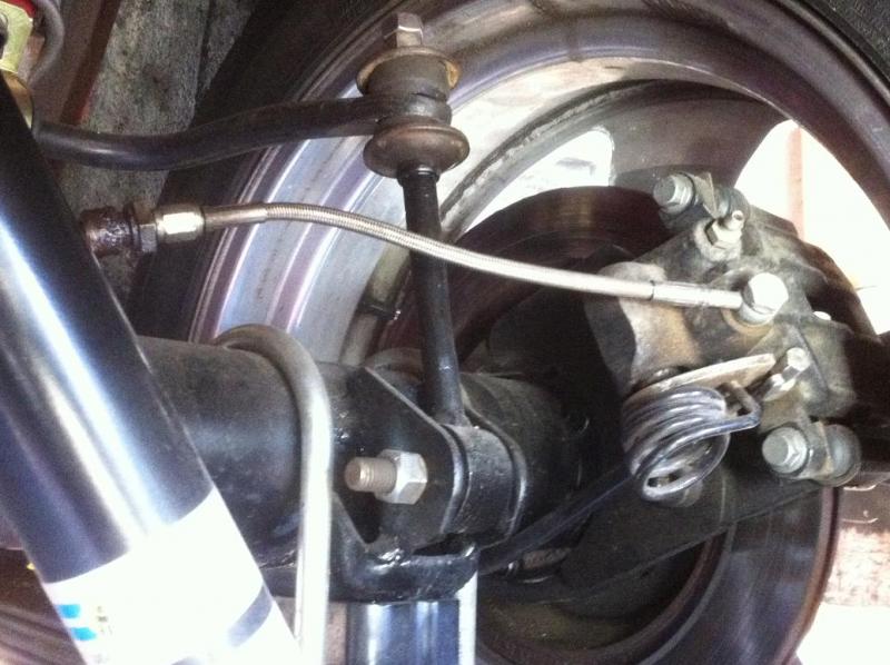

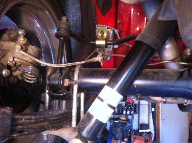

The pictures below are of the 3/4" rear bar. It seems odd that I had such a dramatic difference from just 1/8" of diameter but it is true.
I had to fab up the end links. They originally came on a Ford truck! In original form, they looked like "dog-bone" loops at each end, similar to the end mounts on our rear shocks. See the picture where it mounts to the welded bracket on the axle. At the top, I welded a threaded stud to use traditional urethane bushings. It isn't very pretty but it works well.

When you set up the prefabbed linkage, did you set placement of the bracket mounted on axle by running it up and down to full extent so you knew you had enough swing? I can see that what you have looks great and I am sure functions well. My concern would be that the sway bar doesn't prohibit movement for springs/axle under "hard" conditions. It is probably a trial and error and is different for each car with how everything is set up. I did something similar with the 9" plus the trailing arm suspension I set up in my 55 Belair. I am prepping the axle in the Coronet for sandblasting now and will save this and may even get brackets like this fabbed up for a later install when I get the sway bar. Thank you sir!
I had the car on my lift to get the rear bar installed. I set tall jackstands under the axle and front suspension then lowered the arms of the lift. This allowed the car to be supported by the suspension. I positioned the bar so that the "levers" were horizontal at what equated to the static ride height. This allowed the levers of the bar to have a range of travel almost as far as the leaf springs and shocks allow. What helps is longer levers/arms! A sway bar with short lever arms would surely restrict up and down movement.
