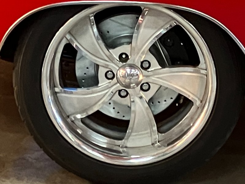

I did wilwood, the pads are readily available. Plus Dr Diff doesn’t have anything that fits my car.
