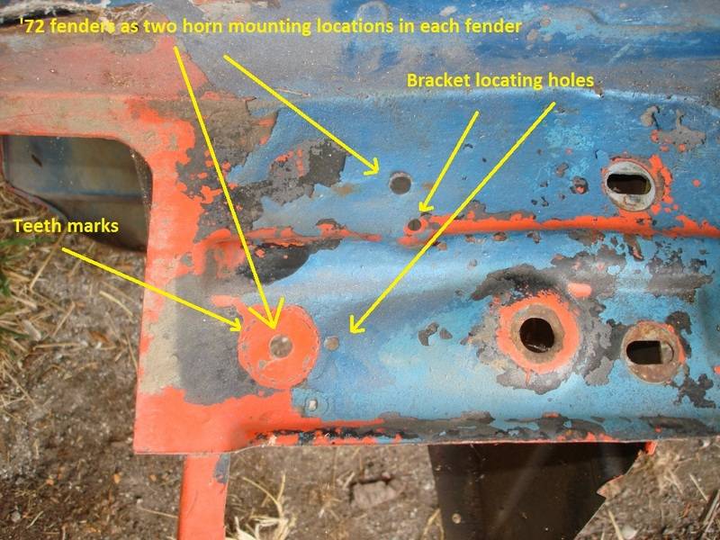

We’re told there is an original 440 engine for it the owner still has, would have to see some back-up on that claim, torque boxes, maybe a vin shot. nothing in the video supports an original “U” code car. Quite a few incorrect mods, ’71 horn in the wrong location, black engine compartment, missing the inner fender struts big block cars got in '72. Somethings about that car just don’t add up to a RR/GTX IMO.
We’re told there is an original 440 engine for it the owner still has, would have to see some back-up on that claim, torque boxes, maybe a vin shot. nothing in the video supports an original “U” code car. Quite a few incorrect mods, ’71 horn in the wrong location, black engine compartment, Missing the inner fender struts big block cars got in '72. Somethings about that car just don’t add up to a RR/GTX.
Sure there are things not original like wheels, gauges, black grille, painted bumpers etc. but I must have missed where he said it was an original concours restoration... I see nothing that says it could not be a U code car that has went through decades of use....

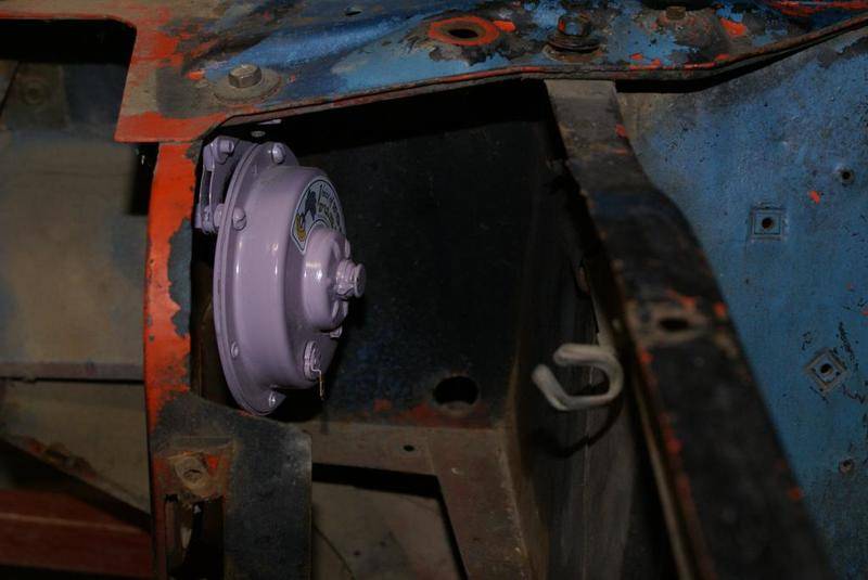

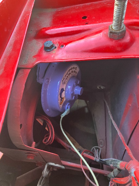

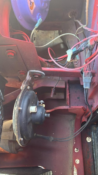

Great video, and I believe that the 72 horn is in the correct location
The ’72 horn mounting is in in the fender supports not the radiator core support as this one is pictured. My original ’72 RR/GTX horn location is on the passenger side.
https://www.forbbodiesonly.com/moparforum/threads/1972-gtx-horn-beep-beep-or-not.79868/
